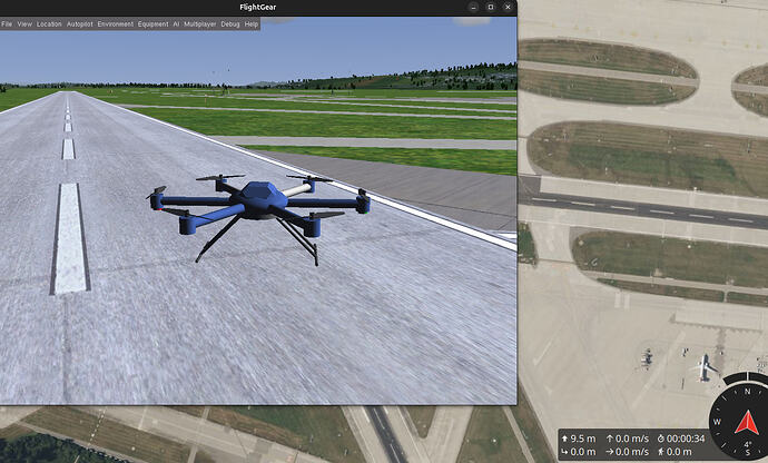

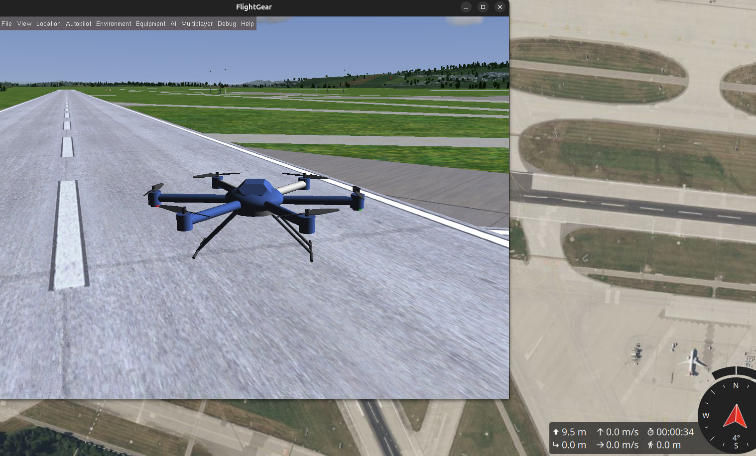

I have successfully integrated a custom F550 hexacopter with PX4 SITL, JSBSim, and FlightGear. The vehicle is able to arm, take off, and respond to commands correctly, but I have observed two issues.
Current behavior
  1. Propellers are not visually rotating in FlightGear
    • The drone generates thrust and flies normally.
    • Position and attitude updates are visible.
    • However, the propellers remain static in the FlightGear model.
  2. Motion is not completely smooth
    • During flight, I occasionally observe small, sudden pitch and roll motions.
    • These disturbances are not severe or unstable, but they appear as brief attitude changes rather than smooth motion.
    • The vehicle remains controllable and continues flying.
