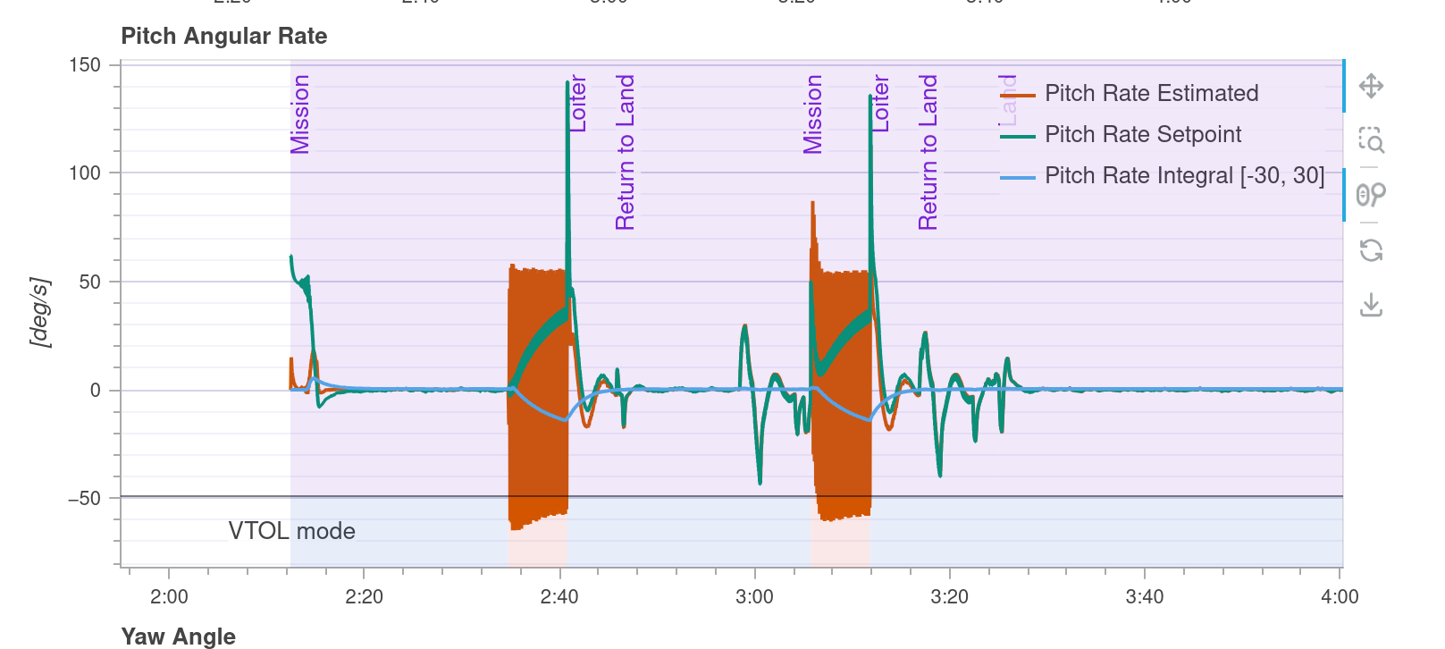

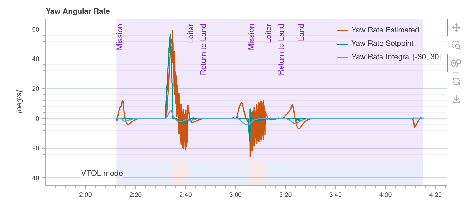

2. The Problem Even though I copied the Inertia values and Joint Axis from the working standard_vtol model, my vehicle instantly becomes unstable (huge vibration in Raw Acceleration and Yaw Rate) as soon as the pusher spins up.

    • Result: Violent Yaw Spin. The physics engine seems to misinterpret the inertia tensor due to the parent link’s rotation.

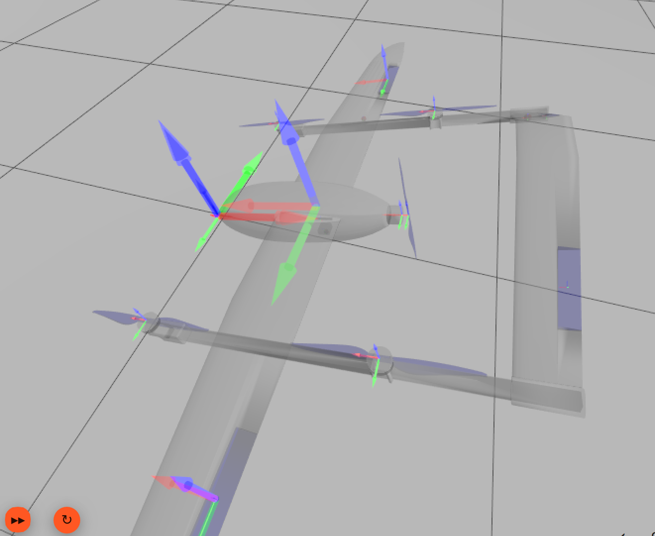

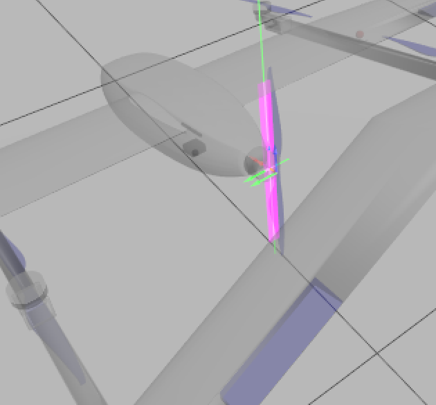

4. Visual Debugging (Pink Box) In View -> Inertia, the pusher’s inertia appears as a long stick (similar to standard_vtol). However, when the motor runs, it seems like the physics engine is trying to spin this “stick” sideways, causing extreme torque/gyroscopic effects.

  • Log Graph: Yaw Rate & Acceleration spike upon pusher activation.

I think the vehicle might be aerodynamically unstable.
What is actually the diff between the standard_vtol model?
To give you more context on the differences from the standard_vtol:
  • SDF File: The main differences are the inertia values (due to our custom airframe shape), motor parameters, and crucially, the LiftDrag plugin settings (since we are using an A-tail instead of a conventional tail).
  • Airframe config (init.d): The only differences are the control allocation position parameters like CA_ROTOR_PX, PY, etc., adjusted for our custom frame.
Regarding the spinning issue shown in the video: I found the cause! It was due to the ground friction and physics glitches caused by the pusher motor’s collision mesh.
However, after removing the collision tag to stop the spinning, I am now facing a new problem: the pusher propeller spins visually, but it generates absolutely no forward thrust.
Do you have any ideas on what might be causing the thrust to disappear entirely?
Could the aircraft become unstable because of the LIFTDrag plugin?
@fe.hyun Of course it can be unstable due to the liftdrag plugin
