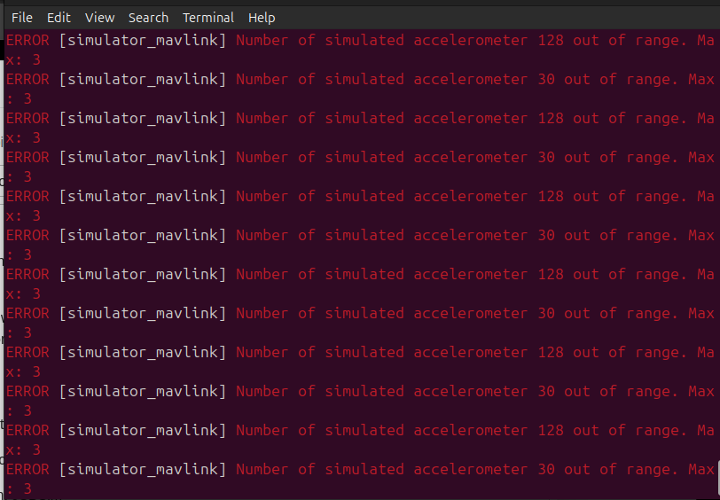

JSBSim hexarotor_x SITL spawns in air above Zurich airport and fails to arm (Ubuntu 24.04)
Hi PX4 community,
I’m trying to run PX4 SITL with JSBSim using the hexarotor_x model on Ubuntu 24.04, but I’m facing an issue where the vehicle spawns already high in the air above Zurich airport and I am unable to arm or control it.
Setup
  • OS: Ubuntu 24.04
  • PX4 version: v1.16.0
  • Simulation: JSBSim Version: 1.1.13
  • Model: hexarotor_x
  • Launch command:
    make px4_sitl jsbsim_hexarotor_x
Problem description
When I launch the simulation:
  • The hexarotor spawns already in the sky above Zurich airport
  • The vehicle appears ready to arm, but:
    I am unable to arm it
    No proper control response is observed
  • It does not start from ground level as expected for a normal takeoff scenario
  • and the terminal shows this output while running
Expected behavior
  • Vehicle should spawn on the ground (or a defined runway/start position)
  • Should allow arming and normal manual/autonomous control
  • Standard SITL behavior similar to other JSBSim or Gazebo airframes
Actual behavior
  • Vehicle spawns mid-air over Zurich airport
  • Arming does not work / fails silently or is blocked
  • No meaningful control authority over the vehicle
What I tried
  • Rebuilding SITL (make clean + rebuild)
  • Re-launching simulation multiple times
  • Checking basic JSBSim launch flow
Questions
  1. Is this a known issue with jsbsim_hexarotor_x model?
  2. Does this airframe require a different startup / launch parameter for ground spawn?
  3. Could this be related to missing or incorrect:
    airframe configuration
    home position initialization
    JSBSim initial conditions file?
  4. Any recommended fix or workaround to force ground spawn and allow arming?
Additional notes
I am on Ubuntu 24.04, so I also wonder if there are compatibility issues with JSBSim + PX4 SITL on this OS version.
Any help or pointers would be appreciated.
