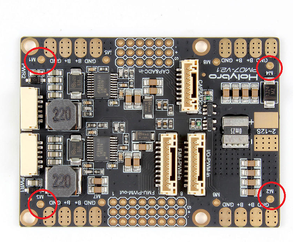

I bought a Holybro X500 kit with Pixhawk4. I assembled all according to the guide https://docs.px4.io/master/en/config/, but the motors do not work. I tested the motors with direct wiring with Radiolink receiver R9DS and they properly run, but when I connect the ESC input to the board PM07 there are not responses.
I verified that all the wire connection are correct, I connected Radiolink R9DS to Pixhawk4 in S.BUS mode.

hello can you send picture of the installation…did you connect the esc signal wire at aux or at the power board esc signal point ???
Picture of the wiring connection for esc to pixhawk power board

I connected according to the picture belove that is reported on the guide Redirecting to latest version of document (main).
I tried to connect the ESC signal (yellow wire) to the 4 I/O PWM OUTS, as in the picture below, and the motors work. Is it necessary to connect also the ground of the ESC to the PM07 board?

hello please connect the esc signal yellow color wire at the M1/M2/M3/M4 please refer to the picture attached
Hello once you connect it as the picture the motor will work 100%
I biught the same kit from Holybro, screwed up connection of ESC to power PM07, then contacted Holybro and got this enclosed image. This will help you.

got exact same problem Changed ESC and everything got fine. I think there’s manufacture troubles on some ESC
the motors work using either method.
