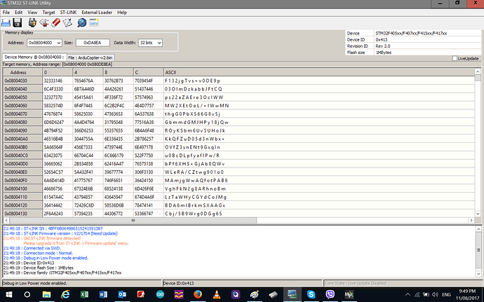

I trying test on STM32F407VGT6 before up on pixhawk.
Let me try with new bootload and new firmware.

I upload bootloader px4fmuv2_bl.bin with address 0x08000000
and firmware ArduCopter-v2.bin ( rename from ArduCopter-v2.px4) with address 0x08004000.
and I connecting with QGC and/or Mission Planner with Uart via FTDI 232 but cann’t connect.
Note: Uart0: PB7,PB8, Uart1: PA2,PA3.
My FTDI232 connect with Pixhawk telem1,telem2,uart4/5 ok.
Please show me, what is my wrong ?

@ReedNoel: I am confused as to what version of the Pixhawk you have.
The Pixhawk has an STM32F427 microcontroller (Device ID: 0x419). Your ST-Link utility says you are trying to flash a STM32F40x or STM32F41x (Device ID: 0x413). If you are flashing firmware that has been compiled for a different microcontroller, it will not work.

I have just had a look at the ArduCopter-v2.px4, there is some script on the begining and the end of the file, I think this file is made to be flashed using a boot loader, you are using st-link to flash it, this method does not use the bootloader.
The file to flash with st-link has to be the binary code on it’s own without the script on the begining and the end, just renaming the file will not work.
Now that you have the bootloaders flashed you could try to connect your pixhawks uart2 to an ftdi adapter and then to a pc and try to use a mission planner or qgroundcontrol to flash the firmware.
