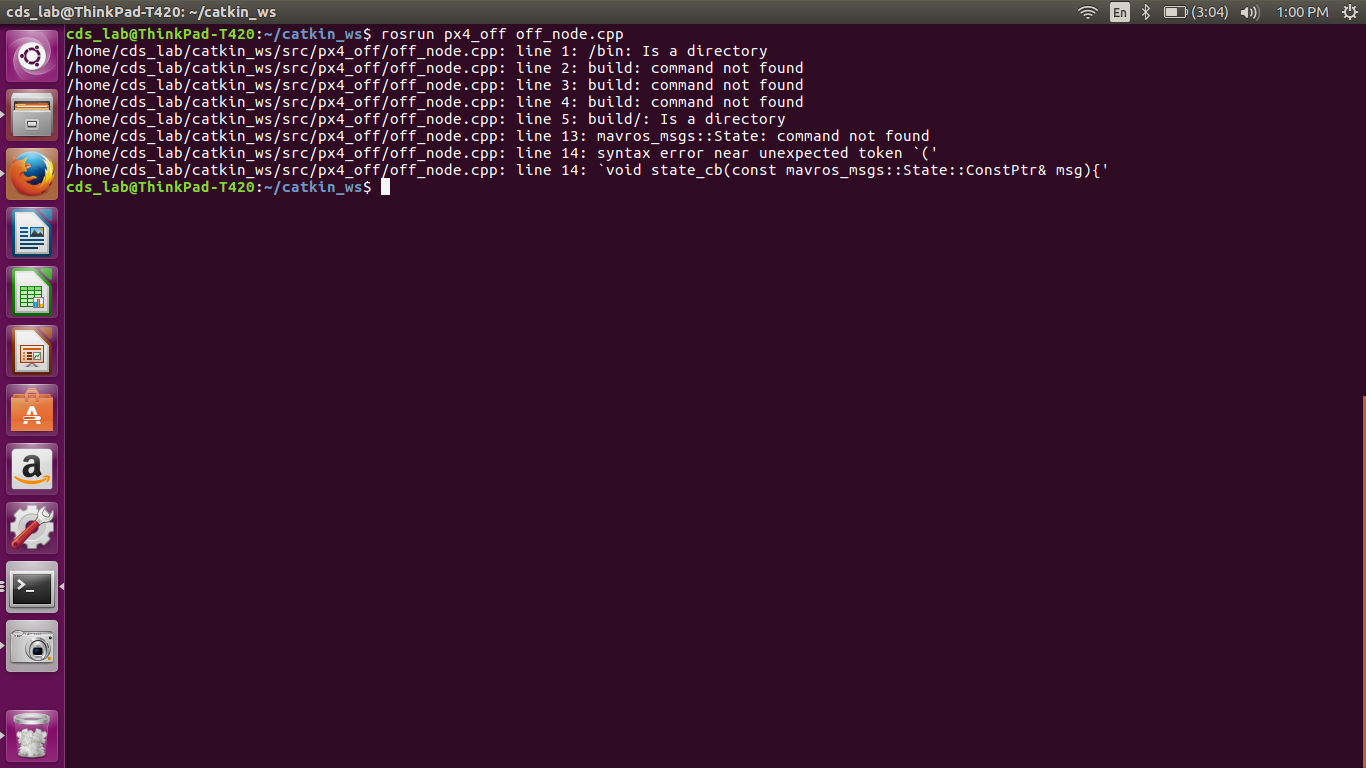

Thank you @Jaeyoung-Lim ! The tutorial says to make a ROS package and copy the node in it. CMake file is then modified by including “add_executable…” consisting of my node. When I run it I am getting some errors as shown in the screenshot below,
I am not as familiar with ROS. I will like to receive your guidance regarding this. Additionally is the Firmware folder (Pixhawk’s source code) required to be in my catkin_ws ?
Thank you for your time ! Apologize for inconvenience.
I know I am missing something out. This is my first time. Apologize for these questions.
@Vrinda Are you able to build your pakcages? It seems like there are syntax errors in your source code
Hello @Jaeyoung-Lim, thanks for getting back to me! I got it to work, I had not modified my cmake file correctly. Additionally I wanted to inform you that in the dev guide, “catkin build” is proposed. However I get some errors with it. When I did catkin_make instead of build, I was able to get the simulation.
