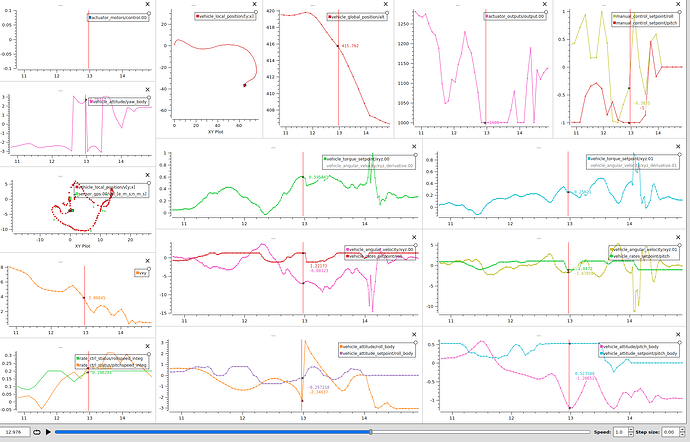

Actually, I often noticed that vehicle was wobbling after “few seconds of flight after takeoff”, and after close examination of the log, I found that most likely it is suffering from PID not being scaled with respect to the airspeed.
Log link: https://logs.px4.io/plot_app?log=e7f3aa9c-9321-4286-a877-90a54d687f92
As I plotted vxy (ground speed) here, you can clearly tell that as the vehicle crosses around 6 m/s mark (as I remove the throttle and let it glide), the vibration goes away.

Update on Flight with no FF gain and just P & I gain
So I did another flight yesterday with 0 FF gain and just P (0.05 for both pitch and roll) and I gain (0.1 for roll, 0.2 for pitch) to check what happens:
Log link: https://logs.px4.io/plot_app?log=fc2f17c6-1699-4cfa-9dbd-5bb488cd2093
It seems like the following are observed:
  1. Maximum roll rate FW_R_RMAX (70 deg/s) is easily surpassed by the vehicle (with roll torque setpoint of less than 0.4, it already reaches 200 deg/s).
  2. Vehicle suddenly nose dives & does a left roll 2 times, then crashes
This is without airspeed scaling in effect, so just the tuning have changed from the last flight.
So my takeaway would then be:
  1. Increase the maximum roll rate to actually meet vehicle’s capability to around 300 deg/s (if it’s too small compared to the capability, I think it becomes prone to losing control authority & be sluggish)
  2. Increase the P gains

Update on Flight with Airspeed scaling
With airspeed scaling applied (by turning on the ground minus wind based airspeed estimation), the ‘fluttering’ issue is now finally gone (rate overshooting and oscillating around the rate setpoint), which makes sense!
However, now I observed that there’s an (almost) bias / barrier between the rate setpoint vs achieved rate. As shown in screenshot below, the rate setpoint for roll is hardly ever reached.
Log link: https://logs.px4.io/plot_app?log=764dd3a1-f2d7-4ca4-997b-d89ba7e90f85
From the fact that as soon as the ‘setpoint’ decreases, the rate follows that direction as well, I can now conclude that the controller is too overpowered with FF gain (hence, the ‘setpoint’ is basically driving the whole control, with no feedback).
You can notice that FF term is the majority of the PID-FF outputs are dominated by the FF gain in the PID component log that I added.

Flight with both roll and pitch P gain 0.05
Log: https://logs.px4.io/plot_app?log=b70dc1f8-fc63-4891-bfa2-cecaede4ee81
For me, here the roll control seems fine (it’s tracking around the setpoint), and it’s just the pitch that’s constantly around -0.1 radians (-6 degrees), while I’m commanding 0.7 radians (45 degrees), that’s not being controlled.
Flight with both roll P gain 0.05, pitch P gain 0.07
Log: https://logs.px4.io/plot_app?log=b9a731ea-1541-4fbc-b0be-0543af38c672
Here too, the pitch seems to be just too low (pitching down).
