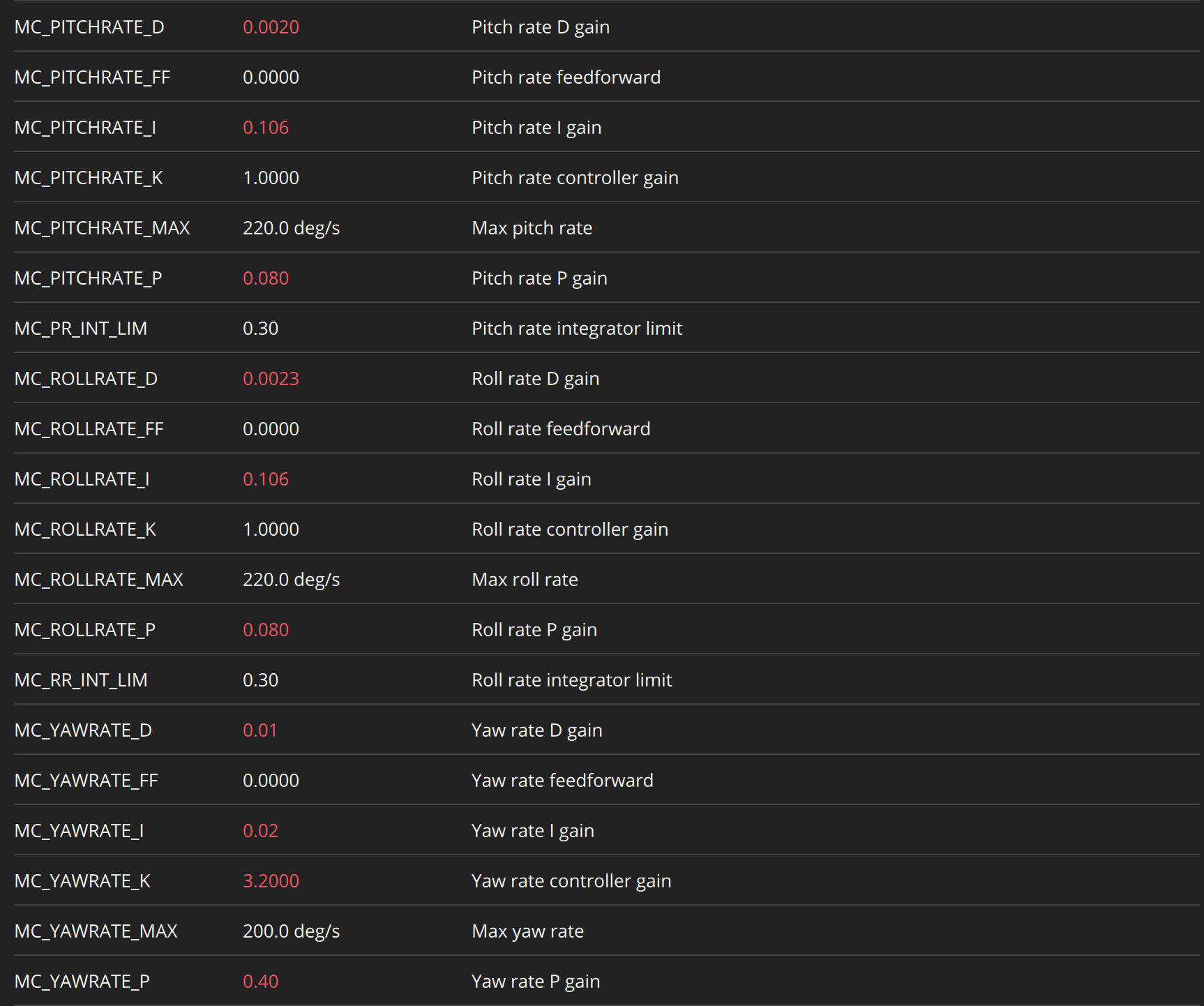

We are trying to develop an airframe with the following config :
  • X frame
  • About 900 mm motor to motor
  • 12S 16Ah
  • Cube Orange
  • GPS Here 3
  • t-motor p60 170kv
And there is no way to find good PID setting to start the tuning.It could be aswell another issue.
Here is my last flight :
https://review.px4.io/plot_app?log=1948b6f6-5f07-43c1-b98d-6e883ddc5892
Our config :
If you have an idea of where to start, it would be great. Thanks for your help
