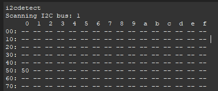

Hey,
I am trying to implement the TFRPM01 sensor into our systems. I am using a pixhawk 2.4.8 flight controller. When using the Mavlink console In QGC, the pcf8583 commands do not work, and do not even show up as a built in app when I use the ‘help’ command . ‘i2cdetect’ shows the hardware is setup as shown below.
i2cdetect_mavlink_console
Can anyone point me into the right direction to get the pcf8583 driver commands to work? I think I have a similar problem to what @RayanR encountered.
You probably have not compiled the PCF8583 driver in the PX4 binary.
The solution is in this pull-request. There also exists an FAQ solving the “PCF8583 missing” issue.
