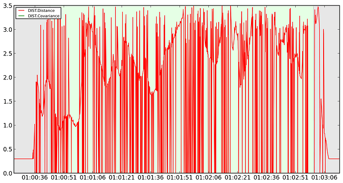

It is running here, but the distance sensor with the PX4Flow is incredibly noisy.
I am looking how to disable it to use the PX4Flow + teraranger (which is very stable)
