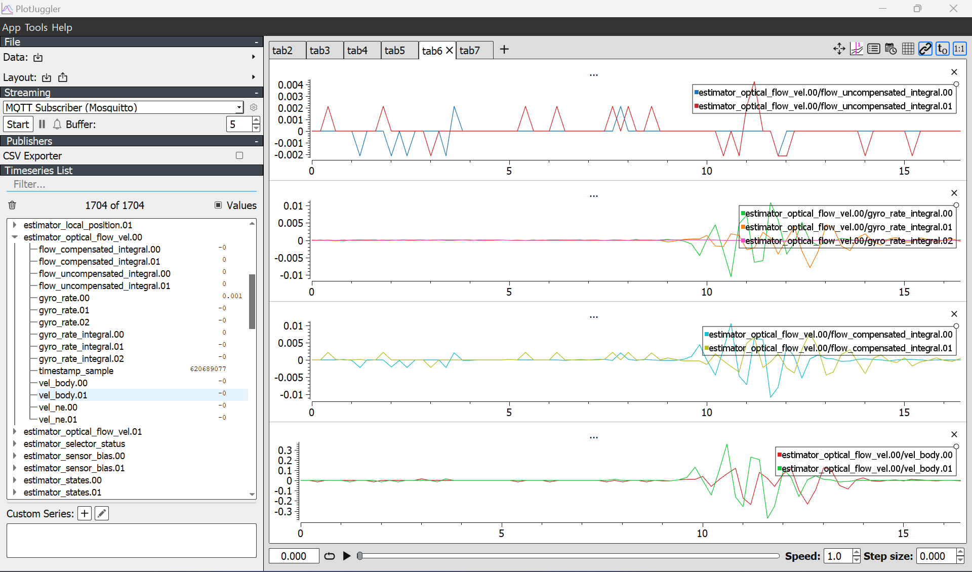

It looks like pixel flow is minimal, might not be but the logging rate is low. The the gyro oscillations are dominating the velocity calculation.

This solution seemed to work to get rid of large oscillations, but we seem to still have a problem with position hold and smaller oscillations. Alex indicated that we should NOT be dampening the arkflow. So we are going to hard mount it to the airframe to see if this resolves our issue.
Alex was able to show us that our compensated flow integral was actual HIGHER than our uncompensated flow integral
This indicates an issue that the gyro is outputting. Probably due to our mounting of it. Thus, we are hard mounting

Wanted to show here what a healthy optical flow chart looks like
this was from Alex btw
