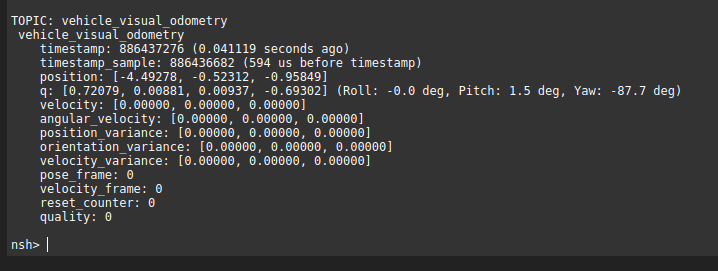

Px4 receives the data successfully as I can run listener vehicle_visual_odometry on the MavLink console and get:
Additionally I can see in the attitude tab of MavLink Inspector that the yaw data is used for state estimation as its value converges to the ground truth whenever I publish to /fmu/in/vehicle_visual_odometry. However, the x, y, z, roll, and pitch values do not change at all.
To publish to /fmu/in/vehicle_visual_odometry I run my own node which just remaps our motion capture data to the XRCE bridge topic and syncs the timestamp as in

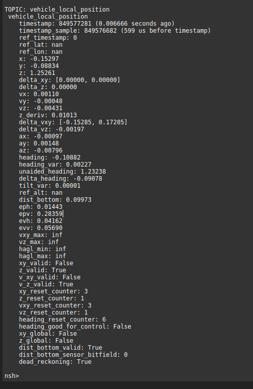

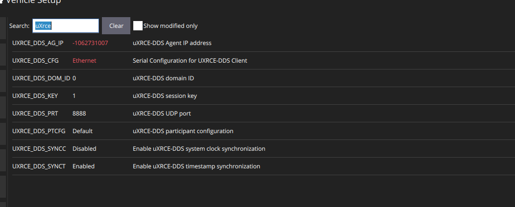

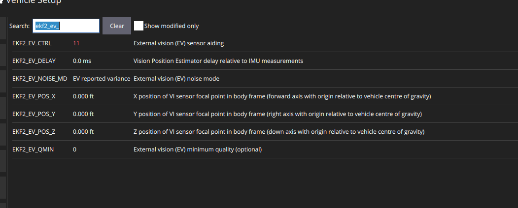

I’ve tried different parameter configurations, mostly modifying the kalman filter and XRCE parameters, without success. Below are my current parameters as well as the output of listener vehicle_local_position. (Note EKF2_EV_CTRL used to be 15, that didn’t work either).
(Why is xy_valid = False?)
