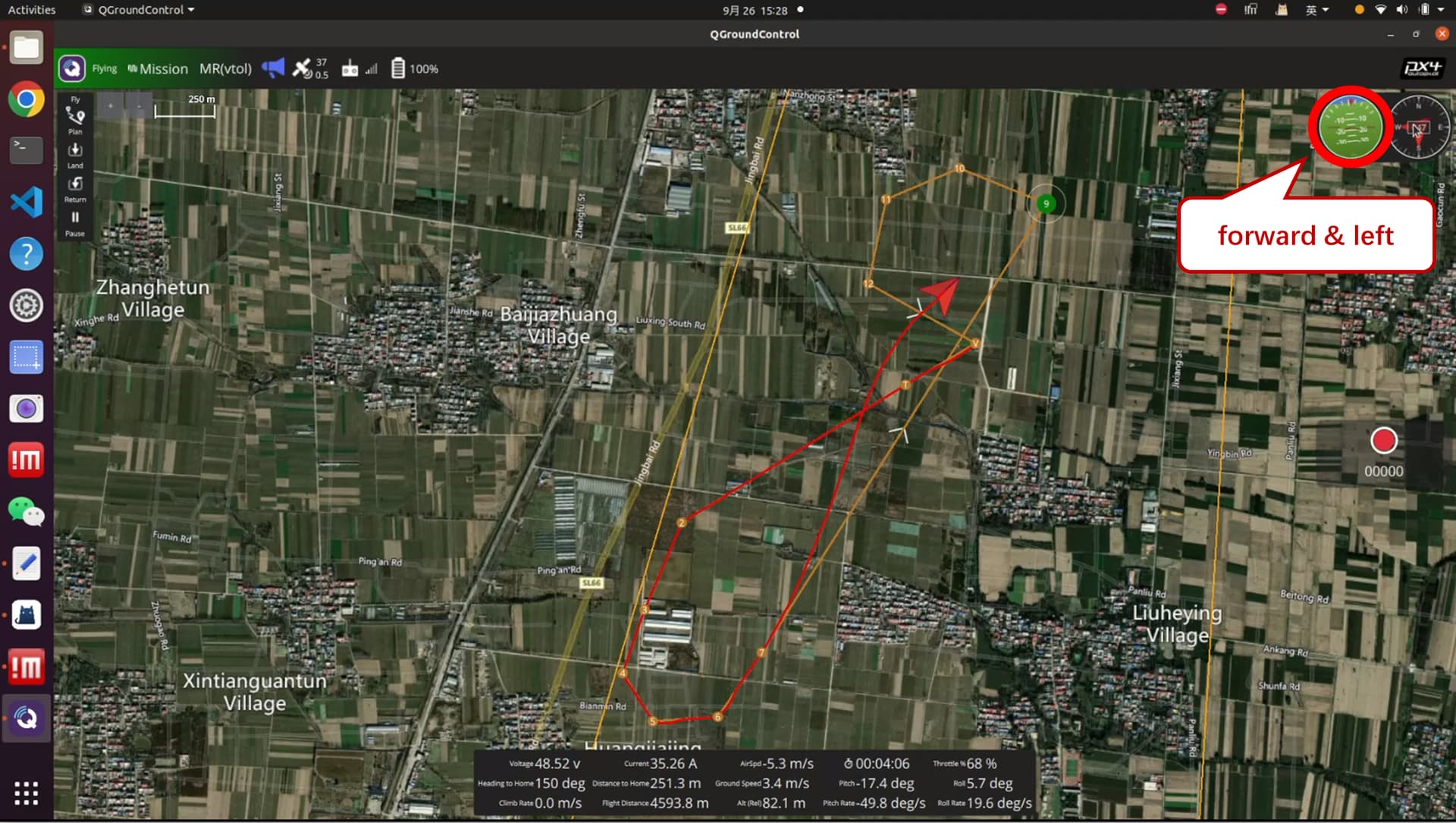

After completing an offboard flight test, the vehicle switched to MR Mission mode. During ascent at 92m, the roll angle suddenly increased, leading to the crash.

  • From the crash video, it can be observed that when the aircraft began to fall, it tilted forward to the left and started rotating counterclockwise.
  • According to the quadrotor motor rotation direction diagram, this phenomenon occurs when the speed of motor No. 3 decreases.

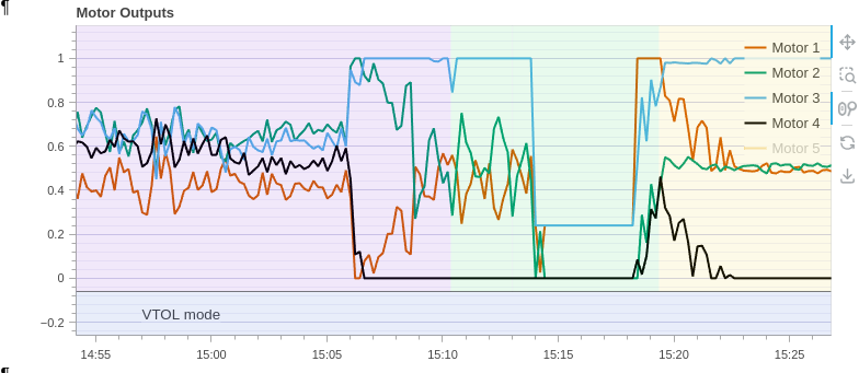

  • From the motor data in the flight log, it can be seen that the crash occurred between 15.06 s and 15.14 s.
  • The PX4 flight controller attempted to maintain stability by increasing the speeds of motors No. 2 and No. 3. Expected the VTOL to roll right.
  • The command for motor No. 3 remained at its maximum value, but the motor did not respond.

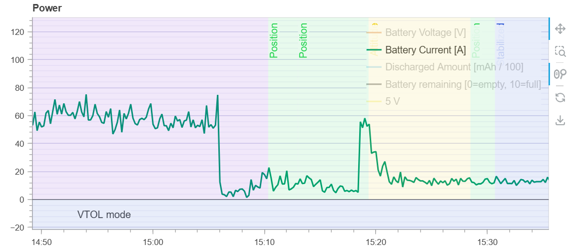

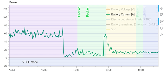

  • The battery current dropped to a very low level during the crash.

  • Did Motor 3 actually fail?
  • What’s the most likely cause of this failure - overheating-induced disconnection or other reasons?
  • Why was the current abnormally low at the end?
  • Is there a relationship between the current anomaly and the motor issue?
