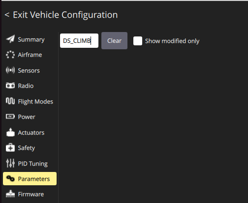

I have a new issue about parameters in my module. In my file “fw_dynamic_soaring_params.c” , the parameters are located in the group @group “FW DS “. But this group and its parameters do not appear in QGC parameters (even after refreshing these parameters).
I tried to see if it is just a problem of display. For instance, I wrote “param show DS_CLIMB_S”, or “param show DS_ENABLE”. And the parameters seem to exist and using “param set <the_params>” enables me to change its value or state.
However, as I said before, the group “FW DS” and the parameters inside (like DS_CLIMB on the picture) do not appear on QGC.
Do you have already experienced this issue or can you help me please ?

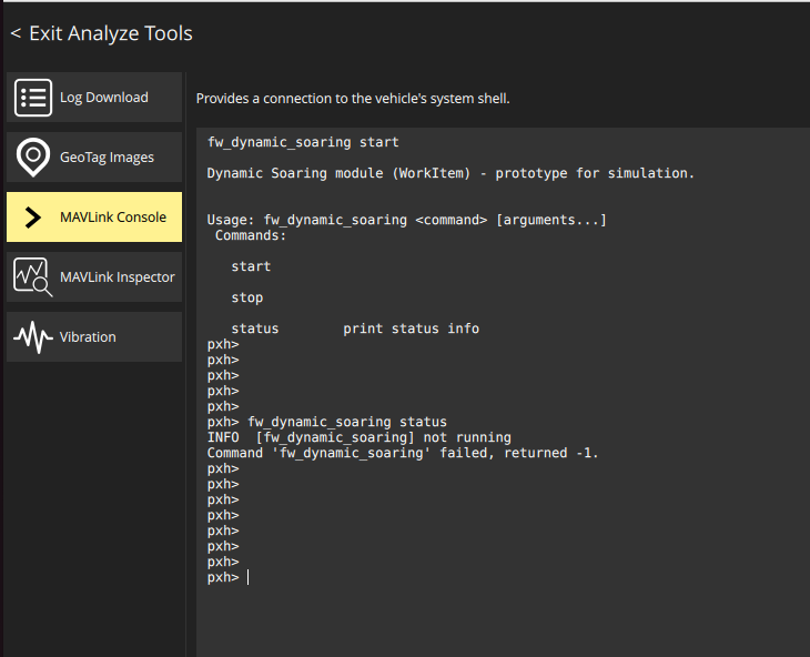

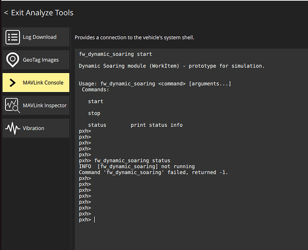

Just to add a description of my problem, in the console MAVLink, I can see that :
Even if I have written start, it says it is not running…
The parameters are only shown in QGC when they are actually used by the system. In your case, you said that “Even if I have written start, it says it is not running…”, so it’s probably not running, and that’s the reason why the parameters are not showing up.
Maybe take as an example another small module (e.g.: PX4-Autopilot/src/modules/mc_hover_thrust_estimator/MulticopterHoverThrustEstimator.cpp at 0ce60fd52813db6a38e2b4b14d8458efb89d505e · PX4/PX4-Autopilot · GitHub) and copy the structure.
