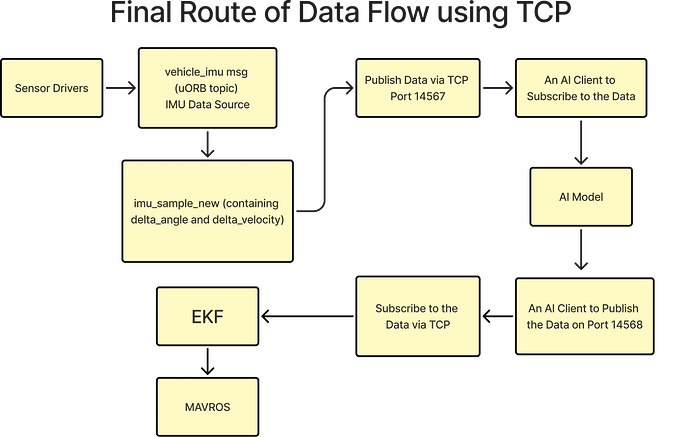

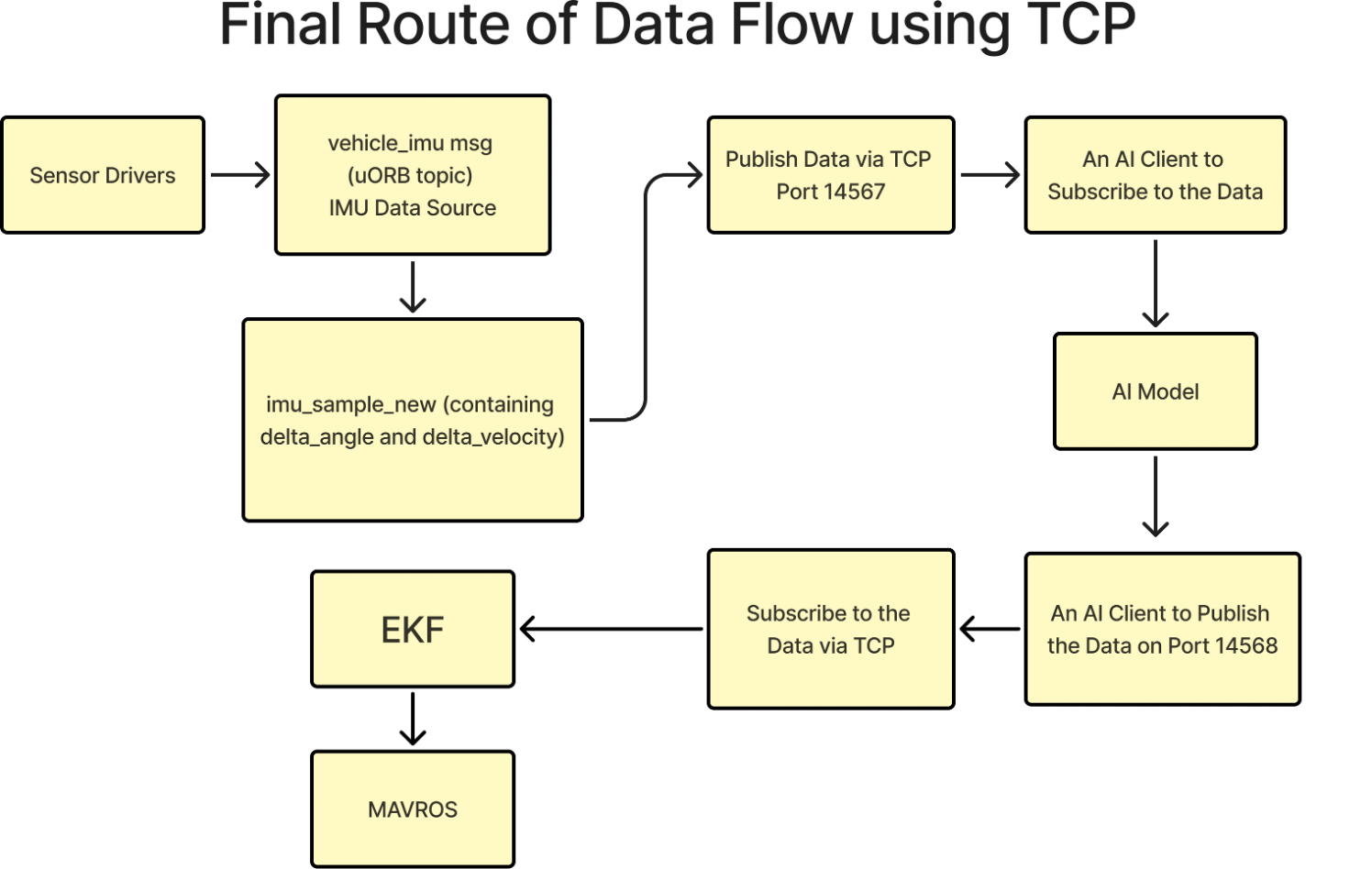

Hi, I tried a TCP-based approach where I broadcast the raw simulator data to my AI model, which then passes it back to my EKF2.
The key point for this task is that the AI model consumes IMU data from the simulator, since its a noise correcting model, so I cannot stop subscribing to it.
Hi, I can’t understand why you couldn’t stop subscribing and what you subscribe to. Could you give more details?
Sure, EKF2 at any given point can only subscribe to one uORB topic for IMU data, in this case its vehicle_imu coming from the Gazebo Simulator.
For SITL Testing, my goal was to use this simulator data, pass it to an AI model, get the corrected IMU readings and send them back to the EKF2.
But I still needed this original data source as that’s my input to the AI model. So in a way I can’t kill that while still not wanting to send that data to EKF2.
I tried sending my corrected data as a new uORB topic which the EKF can subscribe to, but as soon as we were making this switch, EKF de-registers from the original vehicle_imu data and the whole pipeline stops, cause now I’ve killed my original data source.
If you de-register from the vehicle_imu uORB, you’d notice that your MAVROS updates also stops (both /mavros/imu/data and mavros/local_position/pose etc)
My final conclusion after this ordeal was, EKF needed a constant subscription to an IMU data source which automatically polls and consumes the data.
Actually, data from topic vehicle_imu is not raw data. PX4 compenstate some offset and bias before publish data to vehicle_imu. So, I think you need to check imu from gazebo come to which topic (sensor_accel ?).
Yeah that’s correct, the EKF2 performs the bias corrections once it gets the data from vehicle_imu. We export out the data before this stage. Our goal is to pass the data coming from vehicle_imu before it reaches EKF2
If you use AI to correct bias instability and RRW from imu, I think you should do it with raw imu from sensor drivers. I think the 2nd block in your pipeline should move to before EKF (so you dont need to create new topic). The Sensor Drivers block connects directly to imu_sample_new.
Can you please elaborate? didn’t quite understand. Our AI model performs noise correction
I think when you put data through vehicle_imu, your raw data is preprocessed by turn on, thermal and scale factor compenstation, so your AI model will not show full strength on debiasing noise from IMU. And in vehicle_imu data still has the effect from vibration.
