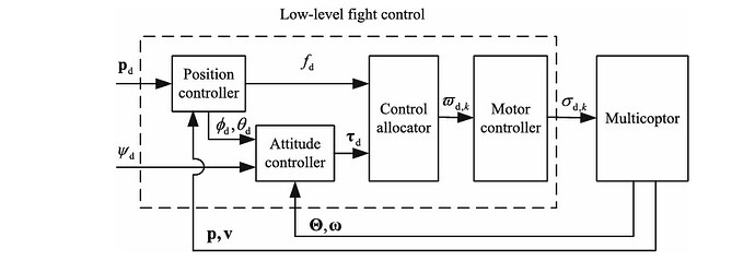

Hi ,
I want to implement the custom flight controller instead of the PX4 default controller(Controller Diagrams | PX4 Guide (main)) in OFFBOARD mode .
Or from my custom controller i am already getting the torques and thrust from which i can also calculate the individal motor’s thrust and angular speed.
so, is there any way to send the obtained desired torques of roll,pitch,yaw and desired thrust to the pixhawk or mapping them to the roll,pitch,yaw or their rates for sending through the SET_ATTITUDE_TARGET .
which is the better way to implement and how to implement.
Firmware:PX4 v1.15
Flight controller:Pixhawk 6X
This is my custom flight controller .
Thanks in Advance!
