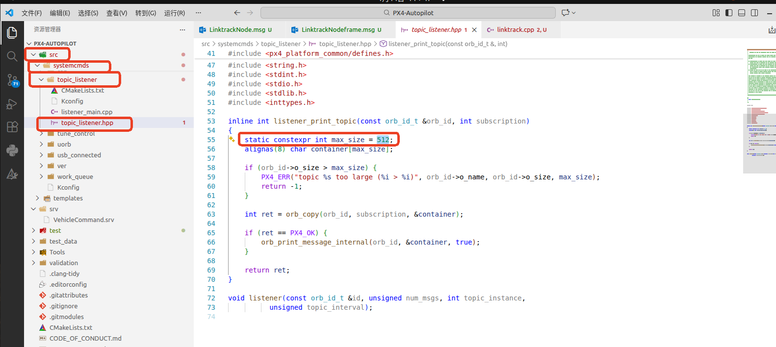

  1. System / QGroundControl restart when modifying listener / message size
    We attempted to increase the allowed message size by modifying topic_listener.hpp and related definitions.
After doing this:
  • PX4 boots normally
  • but QGroundControl repeatedly restarts when using listener or inspecting topics
This suggests that:
  • some parts of the PX4 ecosystem (uORB metadata, MAVLink streaming, or tooling)
    assume standard message sizes
  • increasing message size directly may break these assumptions

Do you need to put the data in uORB? Why not just keep track of it in stack or heap of the one module that needs it?
