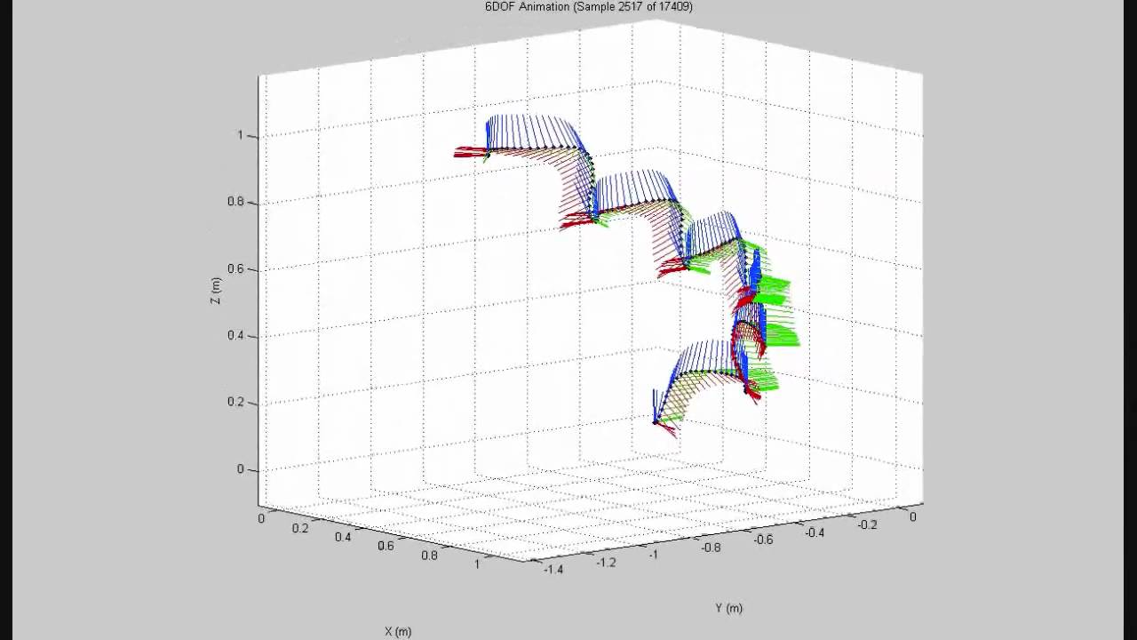

@junwoo0914 when you want to estimate position from accelerations you’re integrating twice, so small accel measurement errors quickly add up to considerable amounts. Over longer time frames it’s not really feasible without other sources as corrections.
Hmm, yea to have precise position estimates, assumptions like footsteps (shown in video below) would be necessary :thinking:
