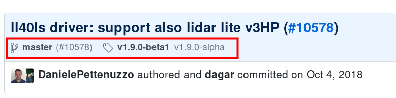

Good question. I’m going here: ll40ls driver: support also lidar lite v3HP by DanielePettenuzzo · Pull Request #10578 · PX4/PX4-Autopilot · GitHub
Then I click on the commit of the squashed commit where the PR was merged into master:
Which gets me here:
And GitHub tells you to which git branches and git tags this commit has been applied to:
This also makes sense because it was merged Oct 4, 2018, and the 1.8.0 release was before that and according to the changelog in https://github.com/PX4/Firmware/releases this fix is not listed to be part of 1.8.1 or 1.8.2.
