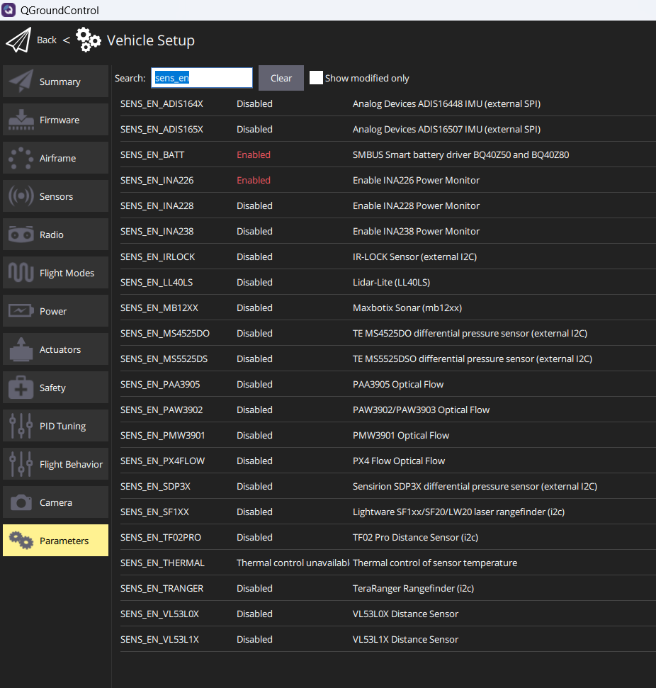

I’m unable to see the battery stats in QGC.
I’m using a Pixhawk 5X with the Holybro PM02D power module (using 12s battery) connected to the Power 1 port.
it shows the battery voltage when 6s battery is connected but it doesn’t shows in 12 s battery.
PX4 Autopilot Pixhawk
Did you set SENS_EN_INA228 to 1 and the other SENS_EN_INA* to 0?
Yes.
I enabled SENS_EN_INA_228 & disabled SENS_EN_INA_226 but still not shows the voltage.
And I tried enabled SENS_EN_INA_226 & disabling SENS_EN_INA_228
it shows incorrect voltage as 40 v. But the measured battery voltage is 50.4(12s LIPO)

from the above two images i enabled SENS_EN_INA228 & disabled SENS_EN_INA226 and it doesnt shows the voltage.
and i have also enabled the SENS_EN_INA226 & disabled the SENS_EN_INA228 and it shows the voltage but wrong readings as ( 40.96v) but my measured battery voltage is 50.4v
