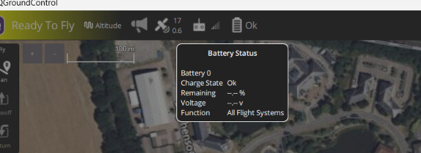

Pixhawk 6X Pro and PM02d high voltage version plugged into Power 1 on a Holybro Jetson baseboard.
PX4 firmware version 1.15.4
QGC version v4.4.4
I’ve ensured:
SENS_EN_INA228 = 1SENS_EN_INA226 = 0BAT1_SOURCE = 0 (Power Module)BAT2_SOURCE = -1 (Disabled)
But in the battery widget on Fly page, I’m seeing:
In Mavlink console, typing dmesg, I get these relevant lines:
INFO [ina228] Failed to init INA228 on bus 1, but will try again periodically.
ina228 #0 on I2C bus 1 (external) address 0x45
INFO [ina228] Failed to init INA228 on bus 2, but will try again periodically.
ina228 #1 on I2C bus 2 (external) address 0x45
I’ve been on this for hours. Can anyone shed any light? Expert advice would be hugely appreciated!
