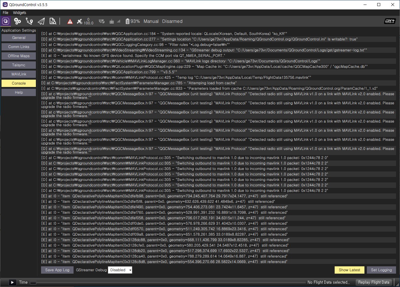

Help. geofence(rally point) transfer failed
I tried several times but failed to fly the mission.
Errors are occurring as shown below.
I’d appreciate your help.
firmware : PX4 Flight Stack Stable Release v1.9.2
controller : Pixhawk 2.1
telemetry : holybro 500mw 915MHz
QGroundControl : 3.5.5
OS : Windows 10
mavlink
QGC is telling you what the problem is. Did you upgrade the radio firmware?
Is the radio version the cause?
I’ll try.
solved. thanks.
