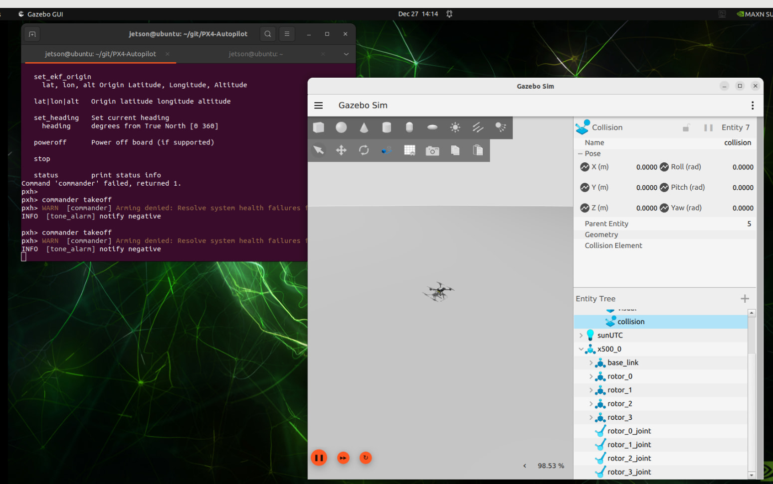

Hi @Joshua_Kordani Will you be able to let me know or who might be able to tell me how to resole the Arming issues? Thank you!
Mustafa
You have to read through the documentation and experiment a bit. You will have to check which prearm check fails. I would e.g suspect you to have no radio/controller connected to the simulation. Either you need to disable that check or connect a gamepad/radio etc.
Thank you for your reply. I appreciate any help that I can get from the experts in this community. I looked at the documentation and found a Python script that sends a heartbeat every 1 second. I am now able to take off with the drone.
Mustafa
