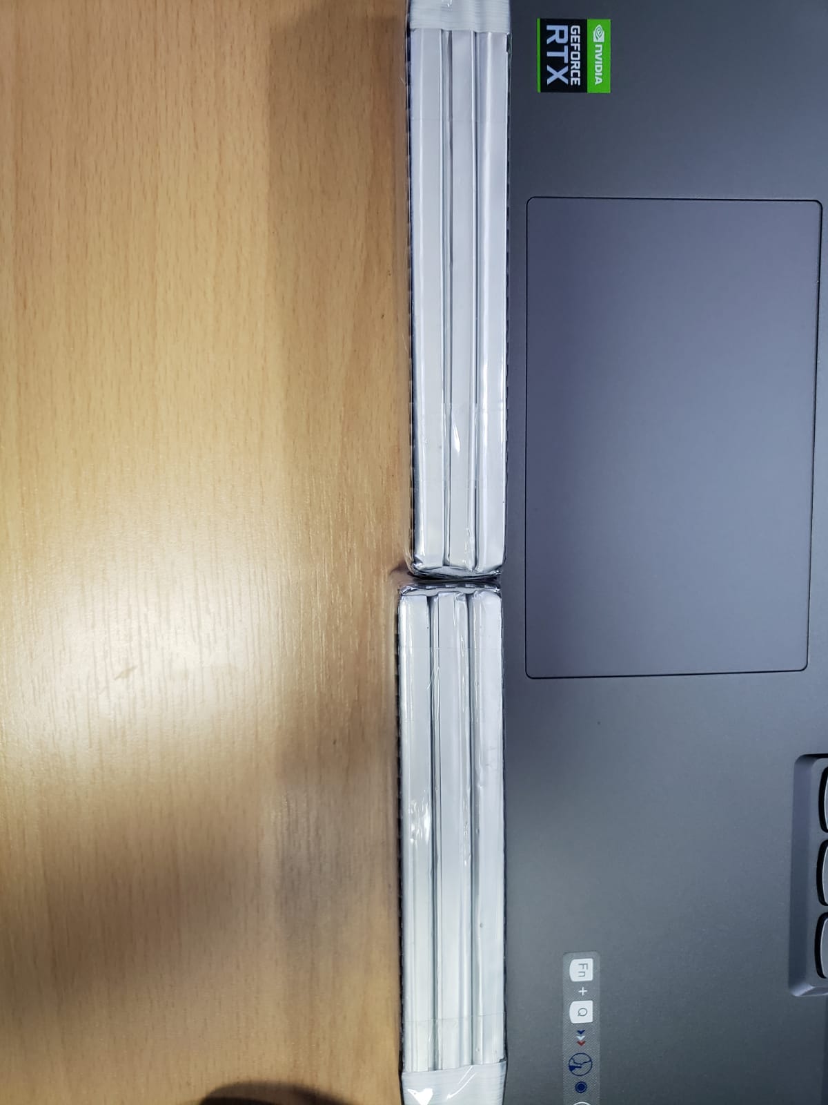

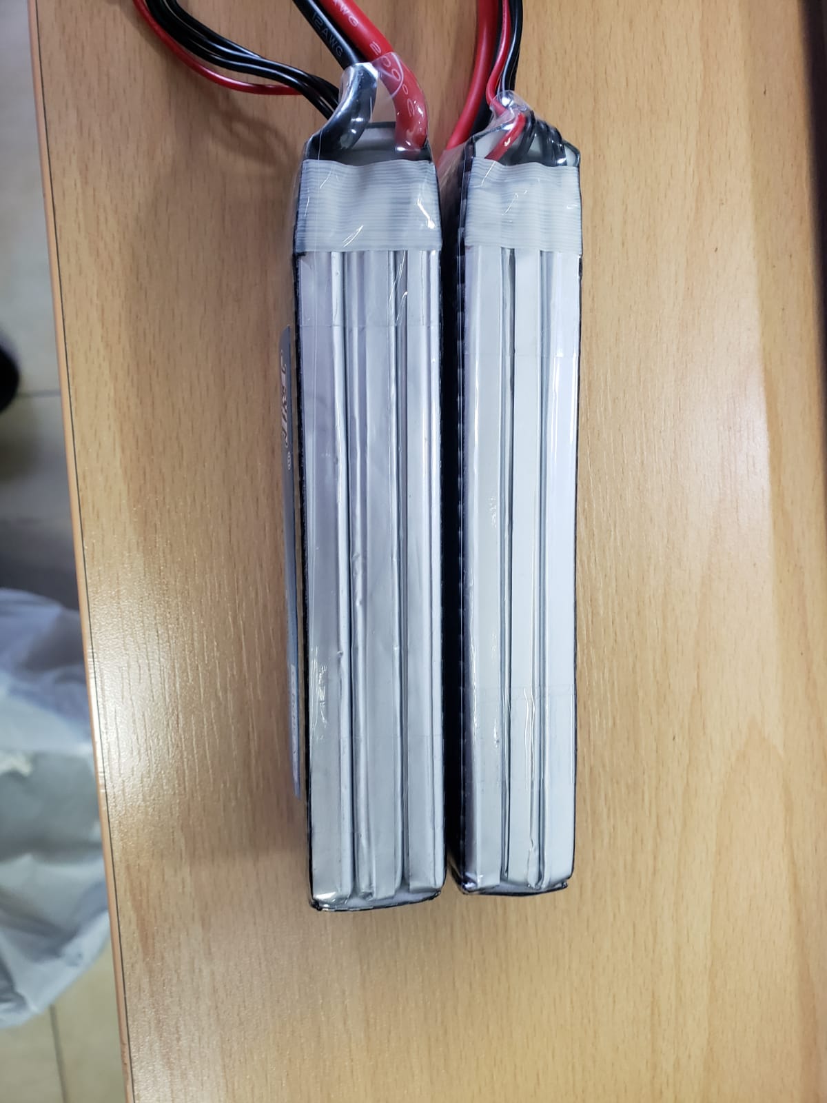

Two months ago I bought two (3s, 11.1 v) lipo batteries, and didn’t use them for flights yet, I just used them for testing motors rotating direction. and I have made sure that the voltage is nominal (3.6-3.8v/cell). however, today I found that one of the batteries is fully discharged! even though I didn’t use it since last charge check, but I left the battery connected to PRM module with open end. I don’t think that this may cause the problem, but this is the only difference between the conditions I left the two batteries in! Also, I think that the battery is swollen a bit. can any one help me with the probable causes? I’m still newbie.
Update: I tried to charge then measure the voltage of the battery, I found out that two cells are charged (3.7), and one is damaged.

If you have two batteries exactly the same and one looks swallow.
Can you take same images of both side by side.
Also measure the voltage on both batteries

The images show the puffy battery beside the normal one.
can I still follow your procedure?

The swollen battery looks precarious therefore I would not proceed for your safety.
On a positive note, you have probably helped a lot of people by showing the difference between a swollen battery and a normal battery as a comparator.
