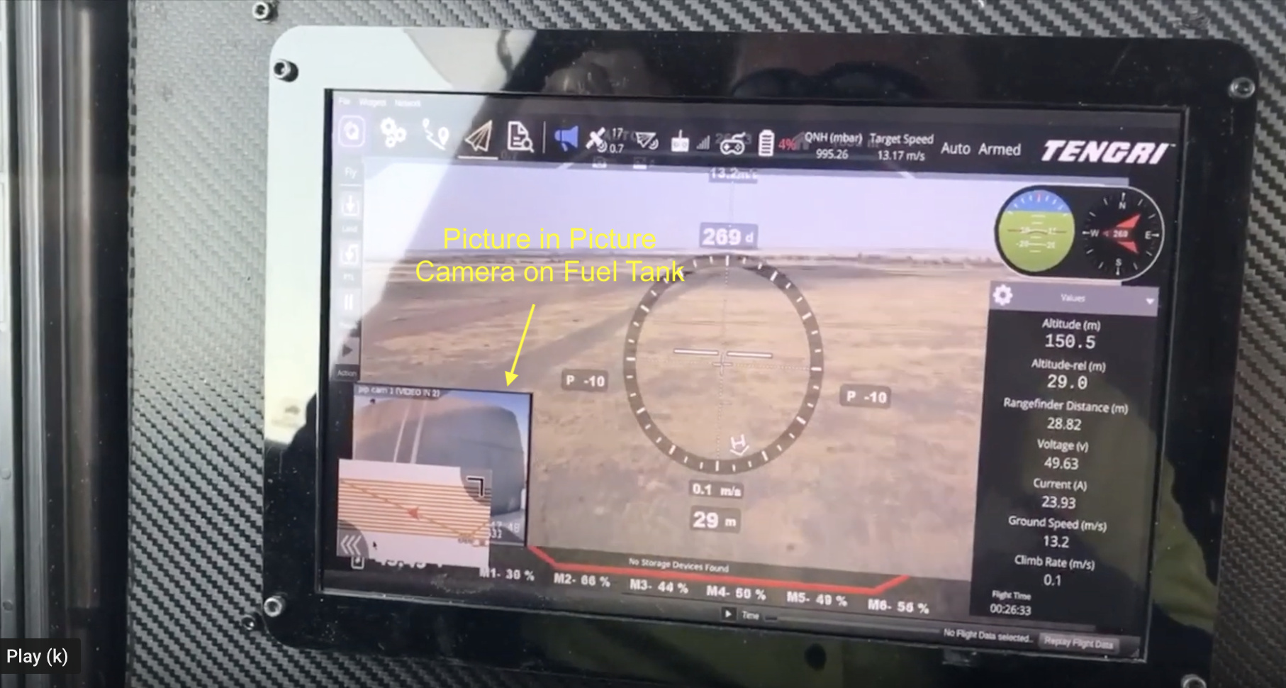

Alternatively use a camera focused on the fuel tank as shown
below
