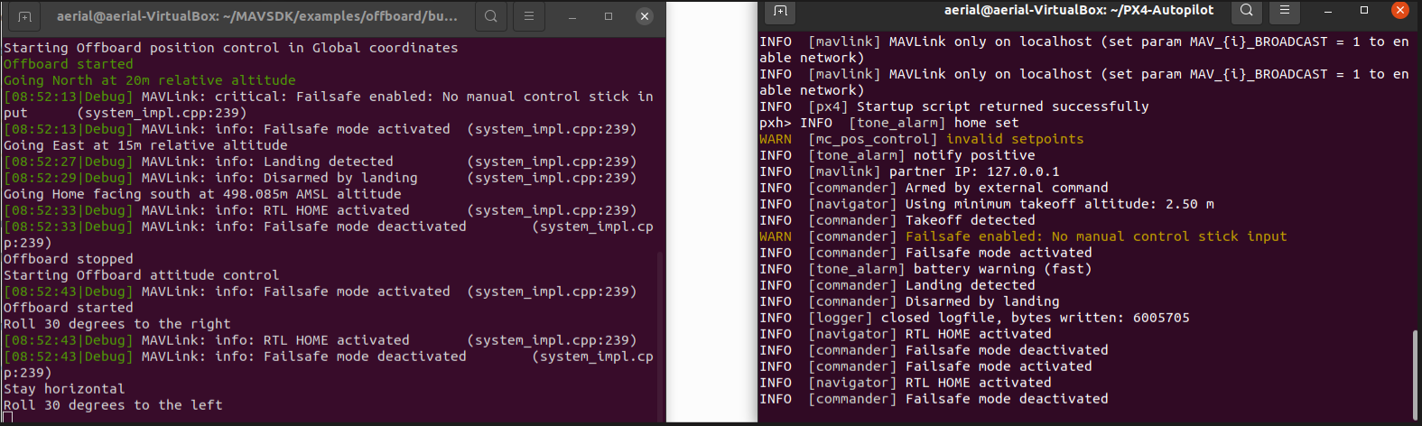

I solved that problem, but when i try to compile the offboard.cpp some errors appear. Did you do anything else apart from compiling? Did you need to change some drone parameters in the QGC?

Hello @Artem_Borisov and thanks for your answers.
This is the error that appears once compiled offboard.cpp and trying to fly the drone.
And answering to your questions, I am simulating the drone in Gazebo, and the drone is not supposed to have GPS, so I would like to make it fly without GPS.
@JuSevRo I see: “Failsafe enabled: No manual control stick in put”. You can change parameter in the QGC COM_RC_IN_MODE to joystick/No RC Checks. Maybe it helps.
