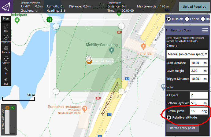

I noticed that in structure scan a camera pitch can be specified:
Wouldn’t it make sense to add the very same field to survey missions as well?
Yes it would and it will be added soon. Until then you can workaround:
  • Create a new Plan
  • Add a waypoint before the Survey. Set the Gimbal angle you want ther
  • Add the Survey and set it to Manual
