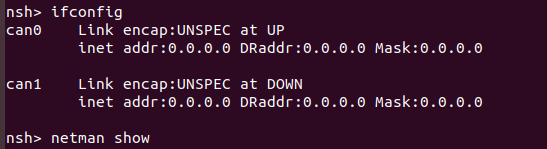

Thank you Benja. It’s directly connect 6x to a PC. Whether need a router to connect board and PC? My computer configuration like that:
I found a problem that 6x can’t ping itself.

I used the ifconfig command to check the network devices and found that there were no Ethernet devices. I had previously configured the CAN network, and I think this issue should be the cause.Because I have a new board, it ping PC successully.
But I don’t know how to bring out the eth0 device.
