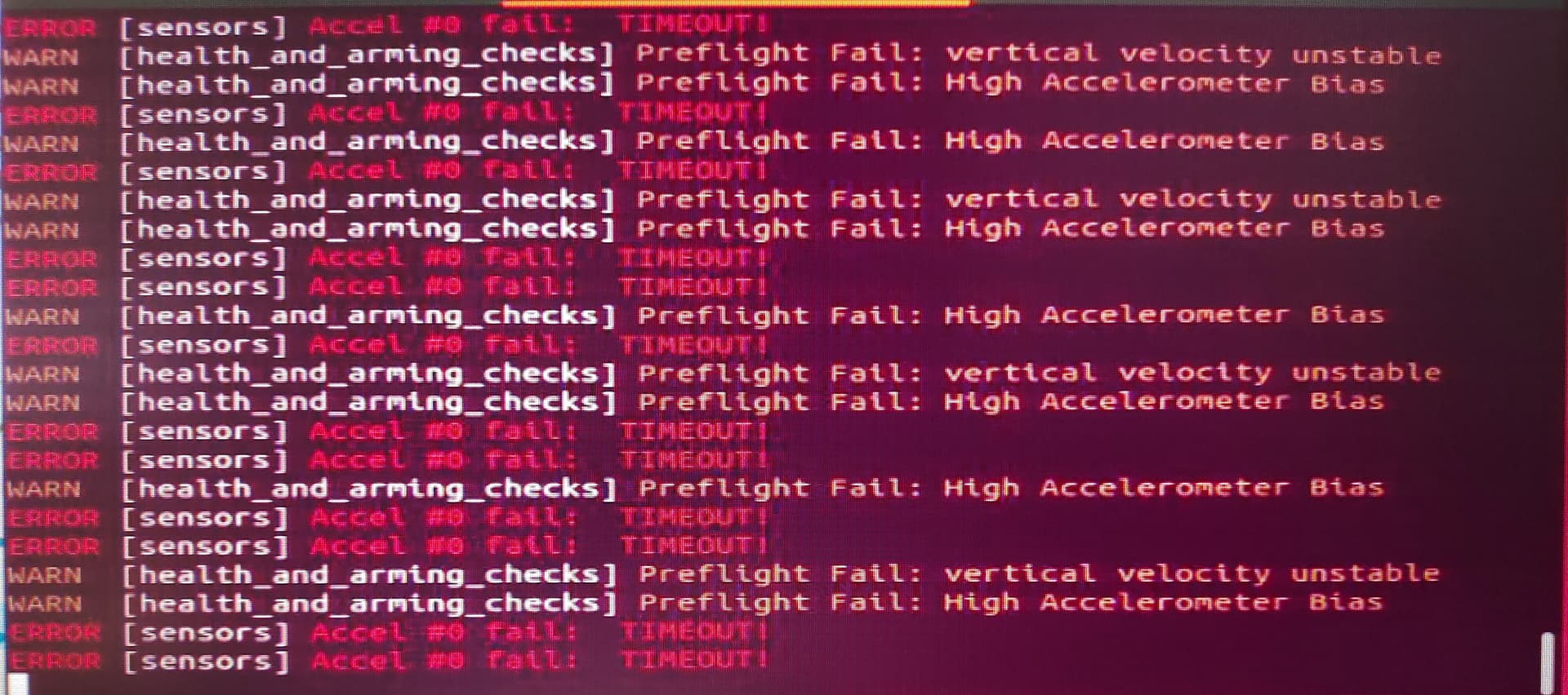

ERROR [sensors] Accel #0 Fail: TIMEOUT!
due to issue above, takeoff will be failed in SITL as the user guide.
More info:
  1. on ubuntu22.04 VM(2*2 core, 8G memory), download latest(1.15.14) px4autopilot
  2. run PX4-Autopilot/Tools/setup/ubuntu.sh to set up env
  3. make px4_sitl gz_x500 to launch px4.
    seems successful, gz sim also launched, but the error above.
What’s the problem?
How to debug or fix it?
Thanks

Yes, the exact version:
VERSION=“22.04.2 LTS (Jammy Jellyfish)”
Finally, I found the issue as JulianOes said in your thread.
it’s the resource issue
So, I will close this post.
where did you find the solution?
For those who are still wondering,
putting the command below in ubuntu’s .profile to slow it down, and make it work.
export PX4_SIM_SPEED_FACTOR=0.1
