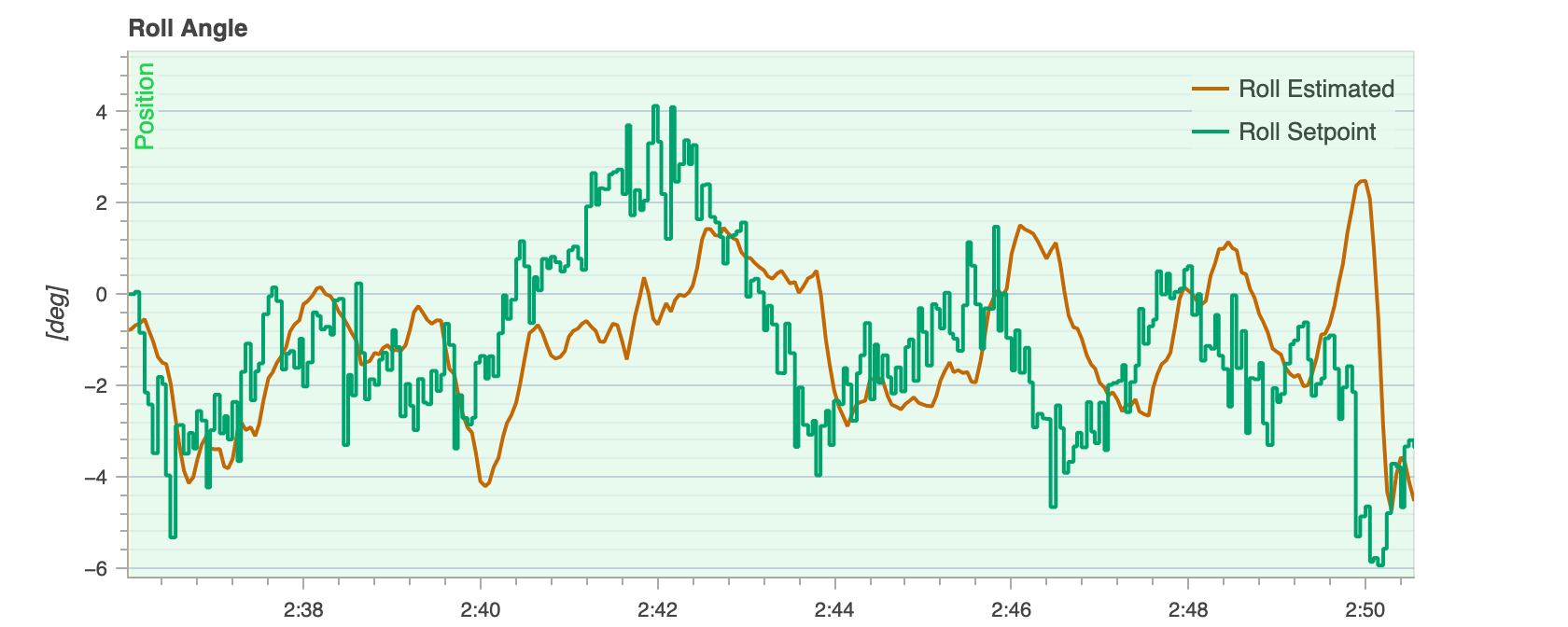

Specifically, I see many accelerometer vibrations since v1.14 which get fed by the position controller D term into the roll and pitch setpoint. Like this log for instance. The roll setpoint has +/-1.5 deg of high frequency oscillations.
I tried implementing a low pass filter in the accelerometer driver itself, before publishing sensor_accel, and this reduced considerably this high frequency oscillations on the roll and pitch setpoints.

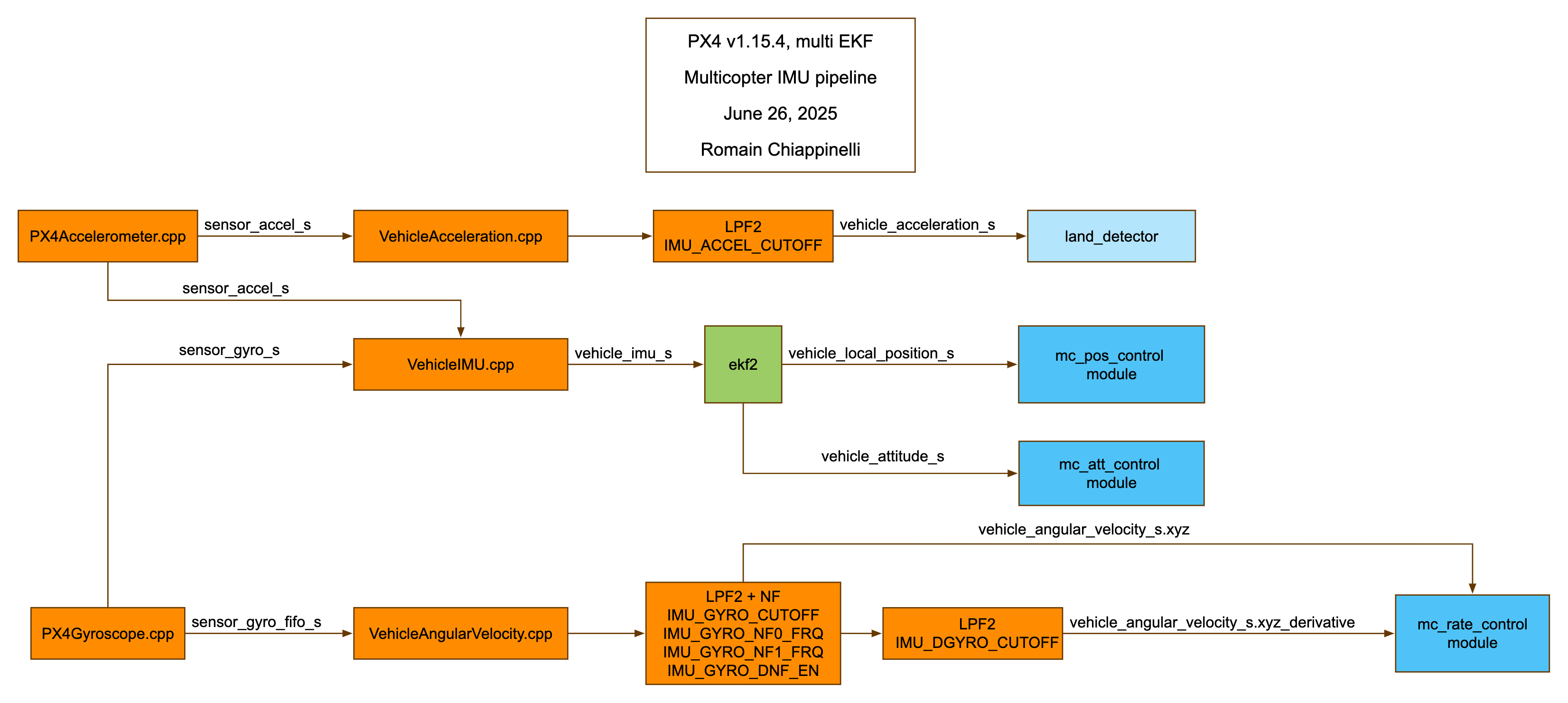

I made a diagram of the IMU signal pipeline from looking directly into the code in v1.15.4, (Please point me the code line if I’m wrong with anything).
A few comments
The cutoff frequency for the 2nd order butterworth filter on the primary accelerometer. This only affects the signal sent to the controllers, not the estimators. 0 disables the filter.
  • As you see in the diagram, the filtered signal vehicle_acceleration_s is not sent to the controller (to the Rover controller yes, not to the multicopter controller). So, if we cannot filter the EKF for stability reasons, can we send the vehicle_acceleration_s to the position controller instead of doing a discrete differentiation on the velocity? Taking the derivative of a high frequency noise signal will amplify this noise. Why not taking (after proper rotation) the filtered acceleration?
Digging in the code, it seems the discrete differentiation of the local inertial velocity into local inertial acceleration is equipped with a first order low pass filter. On which when I call getLP() returns me 5… 5Hz I imagine. Any idea where this is initialized, and how I can change this cutoff frequency?

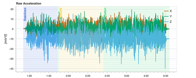

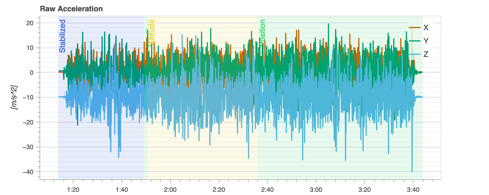

As I understand increasing EKF2_ACC_NOISE with lower the cutoff frequency of the EKF. So the high frequencies will be more smoothed out. However this parameter is clipped (hard coded) to 1.0 m/s/s. And checking my log
the standard deviation of the accelerometer noise is closer to let’s say 5 m/s/s. Although this value of 5 is the optimal, I’m a bit concerned the resulting “cutoff frequency” will be too low for the controller to stabilize the vehicle. Maybe someone knows why this parameter is clipped to 1.0?
I’m aware this (100+ kg) vehicle has a lot of noise. I believe the controller can operate with high frequency noise once it is filtered.
  • I found the answer to this sub-question, this is MPC_VELD_LP
