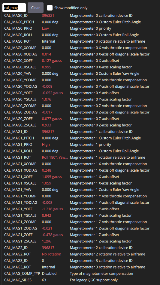

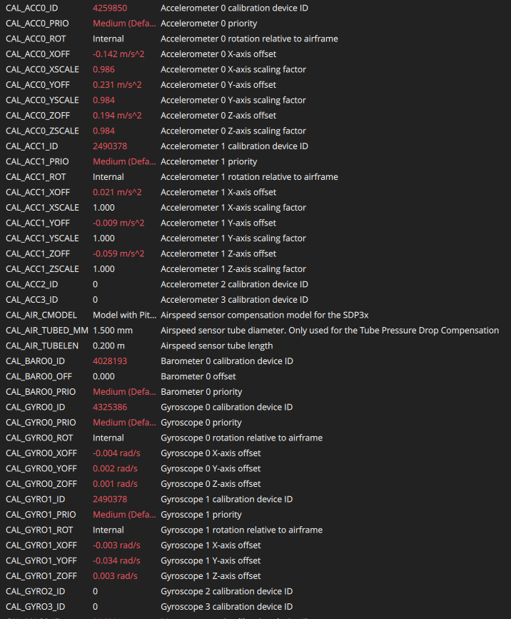

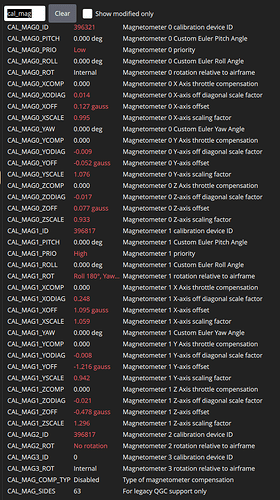

Sensor calibration:
Two logs of test flights:

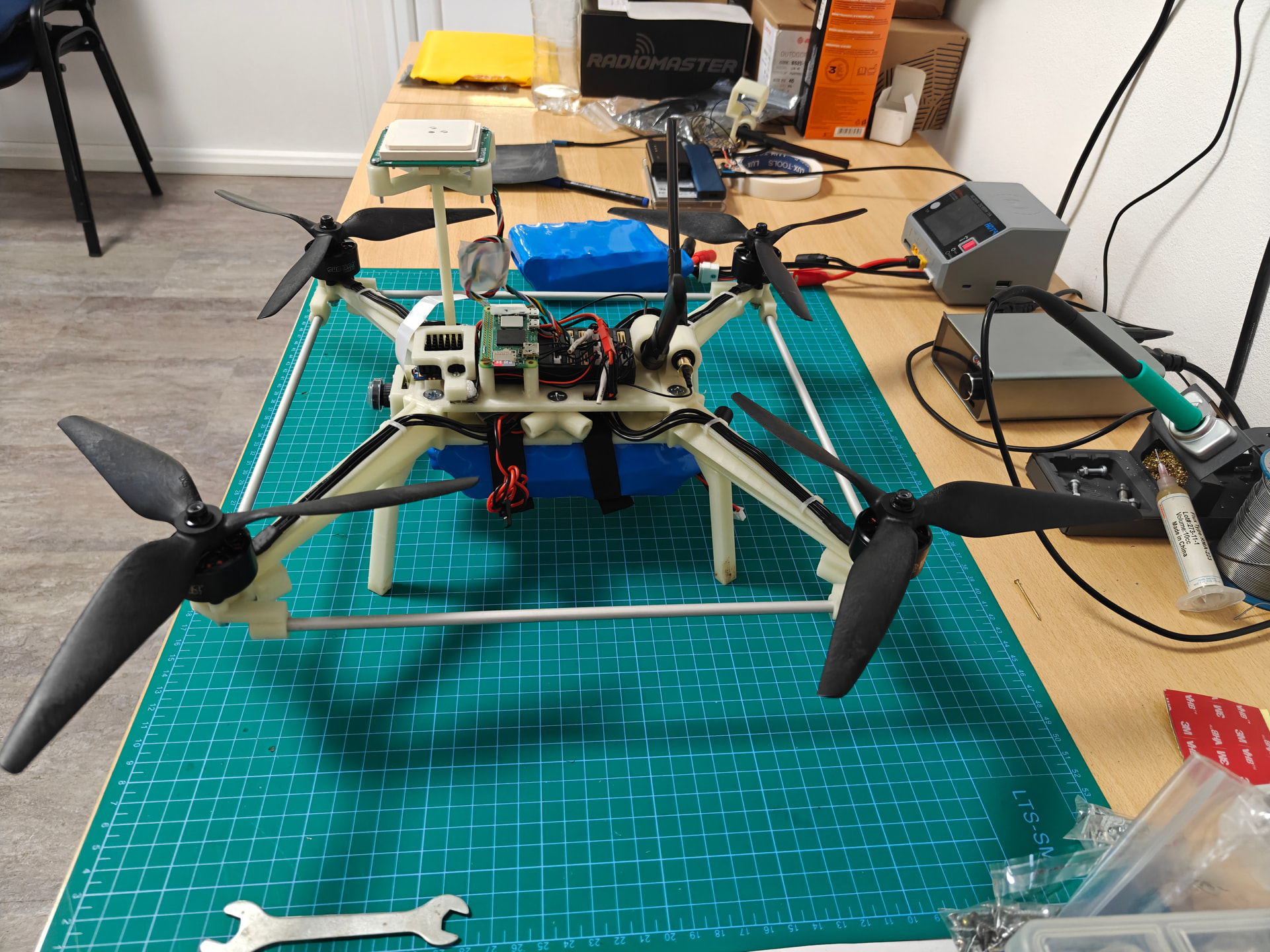

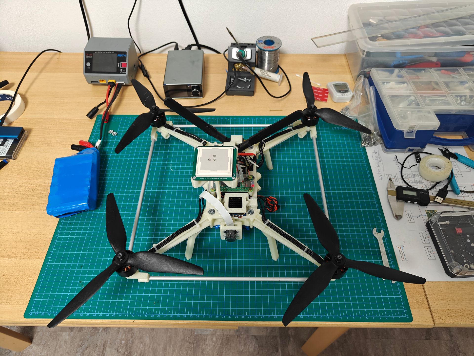

P.S: A few pictures for attention.
