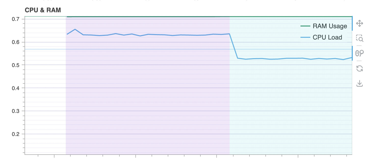

The drone arms and then a few seconds later disarms.
I suspect we may have a number of things setup incorrectly. If anyone could direct us towards the correct resources to read or give us guidance it would be greatly appreciated.

I believe the offending bit in arming_check_error_flags is the CPU/RAM error. We’ve had this error before and at one point had turned lots of things off, reducing the CPU load, but the error didn’t go away. For our current run we get the following CPU graph.

I’m adding my flight review. It now has a bunch of Yaw estimate errors.Flight Review
I downloaded the log file and ran it through an online analysis tool I use called Flight Assistant. It did a great job of parsing the log and immediately highlighted the root cause. It flagged the CPU/RAM overload from the vehicle_status data and showed that your RAM usage was consistently high, which is why you were failing the pre-arm check.

Thank you! We cleared our CPU/RAM overload flag but of course we have more errors. I just tried the Flight Assistant and it’s super helpful!
So there were a bunch of things wrong, we were using both the internal and external magnetometers, we were running two Kalman Filters when we really just needed the one, we did have a CPU load issue, but the thing that was really causing the drone to disarm was COM_DISARM_PRFLT = 10. The drone would disarm after 10 seconds because we’re just testing, we aren’t taking off. The good news is we fixed a lot of things that would have probably been issues later and we are less newbies now. The FlightAssistant is much better than plain ChatGPT for debugging these kinds of issues. Thanks to Jithin.
