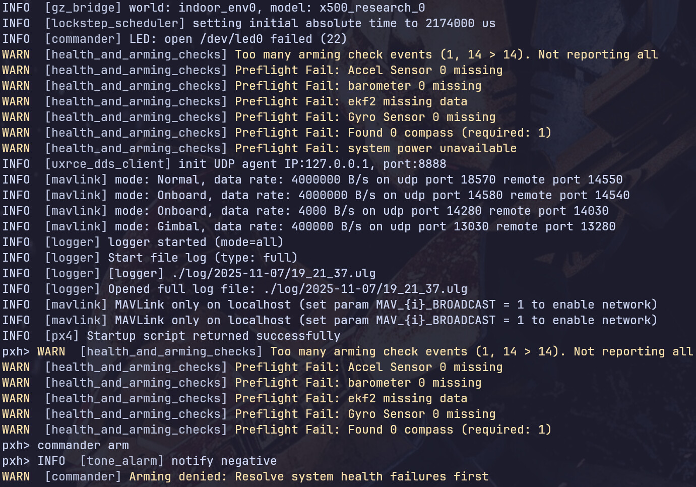

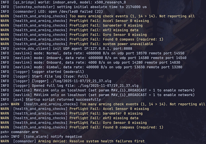

PX4 SITL terminal output? Can you arm and takeoff or no? These messages are unfortunately ā€œnormalā€ and I haven’t figured out the best way to fix it
WARN [health_and_arming_checks] Preflight Fail: ekf2 missing data
WARN [health_and_arming_checks] Preflight Fail: system power unavailable
WARN [health_and_arming_checks] Preflight Fail: No connection to the GCS
This is also relevant if you are doing anything with multi-vehicle
This is the output when i launch px4 and arming does not work unfortunately:
Thank you for taking the time here.
PX4 is not receiving sensor data but it was able to connect to Gazebo and lock to its clock.
does make px4 sitl gz_500 work?
Given that you added the aiframe name to CMakeLists.txt and world and model to the gz submodule, can you run make px4 sitl x500_research_indoor_env0? Does it fail like PX4_SYS_AUTOSTART=4050 ./build/px4_sitl_default/bin/px4?

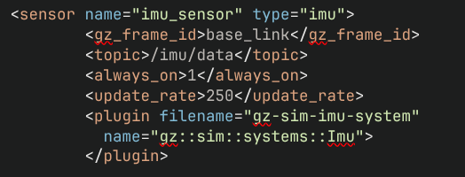

I’m thinking about:
  • IMU sensor placed in the wrong link
  • gz world plugins not loaded correctly (but you said you see the IMU topics in gz)
  • PX4 not fully connected to GZ
From your image, PX4 reports to be using world: indoor_env0 is that indeed the name of your world?
Please share the full log (not as screenshot) of the PX4 process. thanks!
    WARN [health_and_arming_checks] Preflight Fail: No connection to the ground control station
    INFO [tone_alarm] home set
    INFO [uxrce_dds_client] init UDP agent IP:127.0.0.1, port:8888
    INFO [mavlink] mode: Normal, data rate: 4000000 B/s on udp port 18570 remote port 14550
    INFO [mavlink] mode: Onboard, data rate: 4000000 B/s on udp port 14580 remote port 14540
    INFO [mavlink] mode: Onboard, data rate: 4000 B/s on udp port 14280 remote port 14030
    INFO [mavlink] mode: Gimbal, data rate: 400000 B/s on udp port 13030 remote port 13280
    INFO [logger] logger started (mode=all)
    INFO [logger] removing log directory ./log/2025-08-20 to get more space (left=761289 MiB)
    INFO [logger] Start file log (type: full)
    INFO [logger] [logger] ./log/2025-11-08/04_26_26.ulg
    INFO [logger] Opened full log file: ./log/2025-11-08/04_26_26.ulg
    INFO [mavlink] MAVLink only on localhost (set param MAV_{i}BROADCAST = 1 to enable network)
    {i}_BROADCAST = 1 to enable network)
    INFO [px4] Startup script returned successfully
    pxh> WARN [health_and_arming_checks] Preflight Fail: No connection to the ground control station
make px4_sitl gz_x500_research_indoor_env0 returns:

    libEGL warning: egl: failed to create dri2 screen
    INFO [gz_bridge] world: indoor_env0, model: x500_research_0
    INFO [lockstep_scheduler] setting initial absolute time to 2294000 us
    INFO [commander] LED: open /dev/led0 failed (22)
    WARN [health_and_arming_checks] Too many arming check events (1, 14 > 14). Not reporting all
    WARN [health_and_arming_checks] Preflight Fail: Accel Sensor 0 missing
    WARN [health_and_arming_checks] Preflight Fail: barometer 0 missing
    WARN [health_and_arming_checks] Preflight Fail: Gyro Sensor 0 missing
    WARN [health_and_arming_checks] Preflight Fail: Found 0 compass (required: 1)
    INFO [logger] [logger] ./log/2025-11-08/04_28_35.ulg
    INFO [logger] Opened full log file: ./log/2025-11-08/04_28_35.ulg
    pxh> WARN [health_and_arming_checks] Too many arming check events (1, 14 > 14). Not reporting all
INFO [logger] removing log directory ./log/2025-08-18 to get more space (left=761298 MiB)
INFO [logger] [logger] ./log/2025-11-08/04_21_34.ulg
INFO [logger] Opened full log file: ./log/2025-11-08/04_21_34.ulg
Yes. indoor_env0 is the correct custom world. When I launch, the custom world and custom model spawn correctly. It is just the sensors keep failing preflight checks for some reason. I also added an example of my model sdf sensor plugin if that helps below. Thank you for helping me and taking the time.
x500 works but your model does not work. Your model also throws a lot of warnings when spawned. Please check that it complays with the other model structure and naming of link and joints. PX4 is quite rigit with gz topic names and it won’t subscribe to imu, mag, gps gz topic unless they follow the right structure.
Hello Benja,
I am very sorry for the late response. I refactored the model and world files following the documentation strictly and it did get rid of the warnings. Thank you very much for that advice. Even though the warnings are now gone, I am still getting a lot of preflight check failures. Could this be something with how I have the airframe config set up? The gz topics that I created in the sdf files are producing data, however there are other topics x500_research_0…. that are silent. Could PX4 be trying to listen for those instead of the ones I created?
Let me know if you want to see the airframe config or the gz topic list. Or if you think its something else entirely then I will try that as well.
