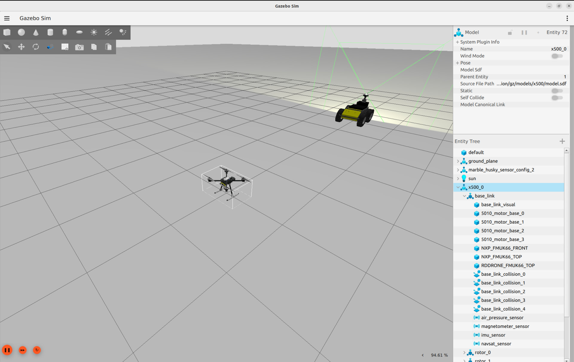

Launch the simulation:
export PX4_GZ_WORLD=landing_zone
export LIBGL_ALWAYS_SOFTWARE=1
make px4_sitl gz_x500
The problem: Preflight sensor failures and missing sensor topics

INFO  [init] Gazebo world is ready
INFO  [init] Spawning Gazebo model
Warning [Utils.cc:132] [/sdf/model[@name=“x500_base”]/link[@name=“base_link”]/sensor[@name=“air_pressure_sensor”]/gz_frame_id:/home/issa/PX4-Autopilot/Tools/simulation/gz/models/x500_base/model.sdf:L219]: XML Element[gz_frame_id], child of element[sensor], not defined in SDF. Copying[gz_frame_id] as children of [sensor].
Warning [Utils.cc:132] [/sdf/model[@name=“x500_base”]/link[@name=“base_link”]/sensor[@name=“magnetometer_sensor”]/gz_frame_id:/home/issa/PX4-Autopilot/Tools/simulation/gz/models/x500_base/model.sdf:L233]: XML Element[gz_frame_id], child of element[sensor], not defined in SDF. Copying[gz_frame_id] as children of [sensor].
Warning [Utils.cc:132] [/sdf/model[@name=“x500_base”]/link[@name=“base_link”]/sensor[@name=“imu_sensor”]/gz_frame_id:/home/issa/PX4-Autopilot/Tools/simulation/gz/models/x500_base/model.sdf:L259]: XML Element[gz_frame_id], child of element[sensor], not defined in SDF. Copying[gz_frame_id] as children of [sensor].
Warning [Utils.cc:132] [/sdf/model[@name=“x500_base”]/link[@name=“base_link”]/sensor[@name=“navsat_sensor”]/gz_frame_id:/home/issa/PX4-Autopilot/Tools/simulation/gz/models/x500_base/model.sdf:L311]: XML Element[gz_frame_id], child of element[sensor], not defined in SDF. Copying[gz_frame_id] as children of [sensor].
INFO  [gz_bridge] world: landing_zone, model: x500_0
INFO  [lockstep_scheduler] setting initial absolute time to 3620000 us
INFO  [init] Setting camera to follow x500_0
INFO  [init] Camera follow offset set to -2.0, -2.0, 2.0
WARN  [health_and_arming_checks] Preflight Fail: Accel Sensor 0 missing
WARN  [health_and_arming_checks] Preflight Fail: barometer 0 missing
WARN  [health_and_arming_checks] Preflight Fail: ekf2 missing data
WARN  [health_and_arming_checks] Preflight Fail: Gyro Sensor 0 missing
WARN  [health_and_arming_checks] Preflight Fail: Found 0 compass (required: 1)
WARN  [health_and_arming_checks] Preflight Fail: No connection to the GCS

Checking sensor topics inside PX4:
pxh> listener sensor_accel 1
never published
pxh> listener sensor_gyro 1
never published
pxh> listener sensor_baro 1
never published
pxh> listener sensor_mag 1
never published
@Benja need your help please
