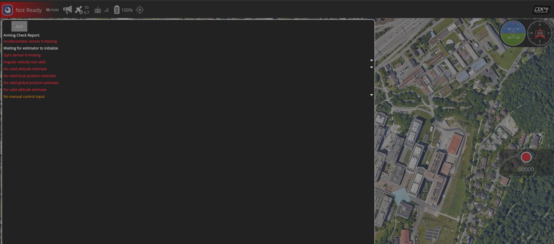

When launching make px4_sitl gz_typhoon_h480, Gazebo starts and the model appears, but I cannot takeoff. Here’s the output, after a make distclean:

pxh> WARN  [health_and_arming_checks] Preflight Fail: Accel Sensor 0 missing
WARN  [health_and_arming_checks] Preflight Fail: ekf2 missing data
WARN  [health_and_arming_checks] Preflight Fail: Gyro Sensor 0 missing
ERROR [ekf2] start failed (-1)
PX4 Exiting...
pxh> Exiting NOW.
ninja: build stopped: interrupted by user.
make: *** [Makefile:232: px4_sitl] Interrupt
It seems like some sensors are missing, but I do not understand how to specify them for the simulation. I’ve seen the parameters for the simulated GPS, Baro and Mag, but nothing more…
Am I missing some other steps? :confused:
Also, in QGroundControl I can see that the sensors are labeled as available, but at the same time the bar at the top of the homepage is red (clicking it gives me the same status), so I’m a little confused!

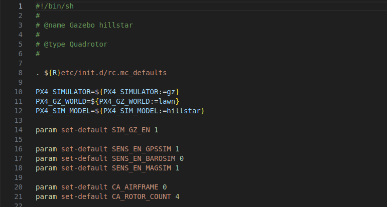

I have a similar issue and the solution did not work for me. I have a custom gazebo model (work in progress). I have added the model file with .sdf and all necessary requirements to spawn it in a gazebo sim with PX4. It initializes without issues but the sensors are missing. I copied the sensors section from a different model, but no luck.
Could someone please suggest if there is any issue? Or, if I missed something.
I have attached my fork of the gazebo-models and the snippet of my init-d-posix/airframes/4022_gz_<model_name> file.
What happens if you remove this line from all the sensors in the sdf?
Try using exactly these lines: PX4-gazebo-models/models/x500_base/model.sdf at db4af69088cccef4549cf3a5c195d5cd97d6b36a · PX4/PX4-gazebo-models · GitHub
Also, PX4-gazebo-models/models/hillstar/model.sdf at d90f59877f48670b2fe5dfd6e3607f1923190925 · snt-arg/PX4-gazebo-models · GitHub this plugin is not supposed to be used here, it is used in gazebo classic.
I tried removing the “parent” from all the sensors, still no luck.
Also, thanks for the tip about gz-classic plugins. I was just trying if the sensors would work with the older plugins earlier, but removed it now.
