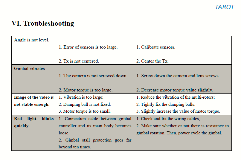

When my drone takeoff, I saw the camera bound with Tarot T4-3D send image with vibration. Is it normal with Tarot T4-3D ? Or is there a problem with my gimbal ?
This isn’t really a Tarot support forum but since there really isn’t one then here you go.
