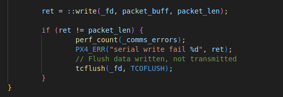

Hi. Naturally you can’t feed mavlink message to your board. It’is waiting for specific messages from MCU. So you should write your custom driver(module) to write to uart port. Adding a custom driver is possible. If you examine existing drivers especially which are using uart you can see the way. Basically there is no big difference than connecting an arduino to the servo board with uart.
In documents you can see basics of driver development:
As document says best way is use a driver as template. I have written a few for unsupported sensors but I was only reading coming data. And I only followed tfmini lidar driver as template I only changed decoding part. As I see lightware_sf45_serial driver using uart port and including both read and write parts. Probably it can be a good point to start for you.(src/drivers/distance_sensor/)
There is a reading part as you can see
And also a writing part
Most of the part will not change. If you’re familiar with uart communication with mcu like stm32 you can implement this quickly. If you’re not familiar still it’s not so hard you can adapt an existing driver. In such cases using debug messages with PX4_INFO very helpful.
