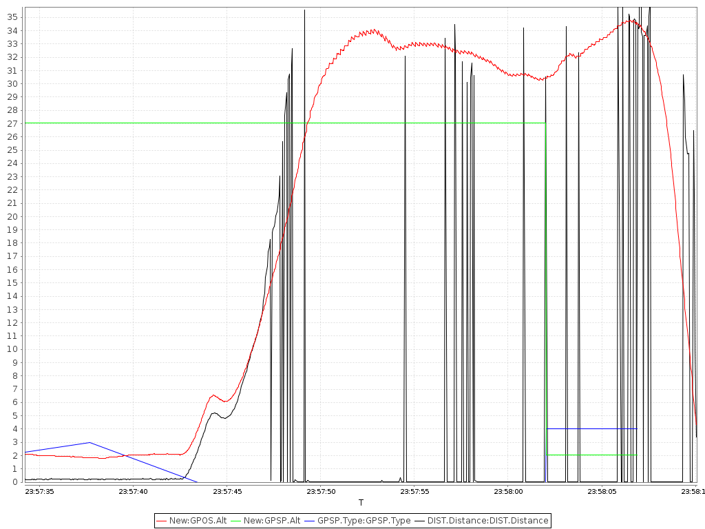

Thanks for opening that. I went back so a firmware I had been using problem free but it essentially tried the same thing. This time a log file. HERE New components used, checked over LIDAR, etc. Why did it try and flare 3-4 waypoints early? Is this something to do with the acceptable radius of the waypoint (i.e. if you are on wp 4 and wp 6 is pre-landing but 6 acceptable radius is within the bounds of the current wp then it jumps to 6? I am lost on this one. I used the same software on THIS flight (different plane) and no issues.
Red is your altitude, green is the altitude setpoint. When it drops to 0 you’re on landing approach. GPSP.Type is the waypoint type (blue line), and a value of 4 is LAND.
I don’t have much experience with lidar, but it appears to only be valid below ~ 15 meters, but you’re entering landing above. Realistically the code needs to be updated to safely handle this, but in the meantime if you’re going to use lidar I suggest you get to an appropriate altitude before entering your auto land.
For reference here’s what it looks like in the good log (same software different plane, no issues) http://logs.uaventure.com/view/R9BAuNj5yRxZVr89o6fSSZ
