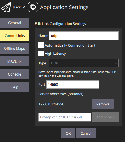

And I already set ‘Comm Links’ like the below figure. (127.0.0.1 is the LOOPBACK ip address)

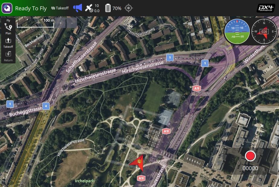

Then, At the QGC, it shows like the connection is completed.
But when I try to command at the QGC (takeoff or something…), It doesn’t work at all.
I think the port is opened correctly, and CCS problem does not effect that much to my simulation. Is this problem can be the reason? if not, what is the problem and how to solve this problem?
