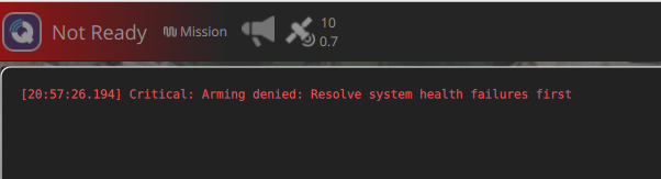

I am trying to test a mission using SITL but whenever I try to arm I get an error that:
“Arming denied: Resolve system health failures first”
I get no other details about why the arming checks failed. When I run ‘commander status’ in a mavlink console in QGC, I get the following output:

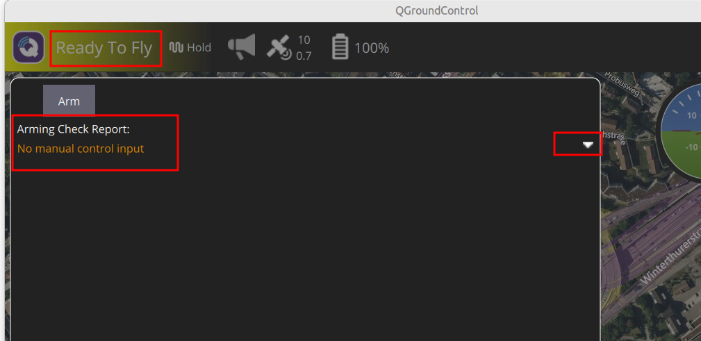

You have to know where they are, click on the red (or yellow) part in the top bar to get a list of the failures, see screenshot below:
Thank you for your response. Before I try to arm I get the following message when I select mission mode:
Once I try to arm with MAV_CMD_COMPONENT_ARM_DISARM I get the following messages:

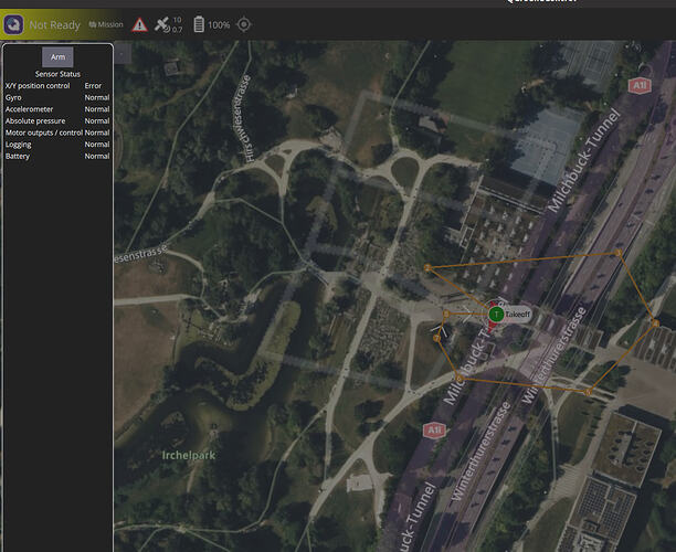

I have no trouble arming and simulating a flight using manual controls with the following modes (and maybe others that I have not tried): manual, altitude, position.
Do you have a valid mission uploaded when you try to do this?
Hi I am also facing same issue. I am doing sitl for x500_depth. I have a valid mission as well. Could you share your thoughts please
Edited: It looks like the “world” is creating some issue. With “default” world i am not getting this error. but when l load custom world (with some cars trucks and a human) I am getting this issue. Same issue is observed when I repeated with vtol paltform.
When I try to arm and launch I get error in QGCS saying MAV_CMD_COMPONENT_ARM_DISARM command temporarily rejected.
Interesting, so it’s something about this world triggering it? Maybe the model is somehow stuck or oscillating? Or does it have to do with _depth?
