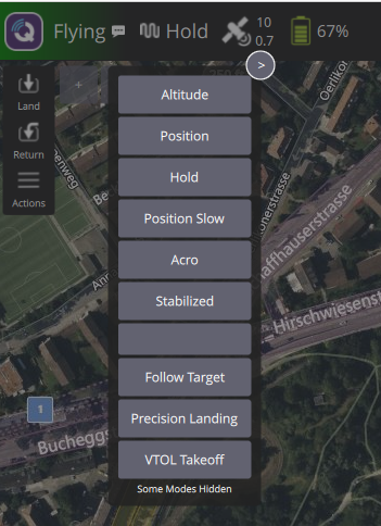

Hello, I have my PX4 (SITL) x500 drone took off from QGC but I can not further see the offboard mode in QGC. The screenshot is also attached.

Have you given the trajectory setpoints sometimes, the mode is not shown until to publish data for offboard look at the following ROS 2 Offboard . If it doesn’t work, reinstall or downgrade the QGC
Yes, I also tried publishing the trajectory setpoints but it still does not show the Offboard mode in QGC. I will try re-installing or downgrading it.
If you install the QGC daily build. Install the stable version instead
Sure, thanks! I will do as suggested.
