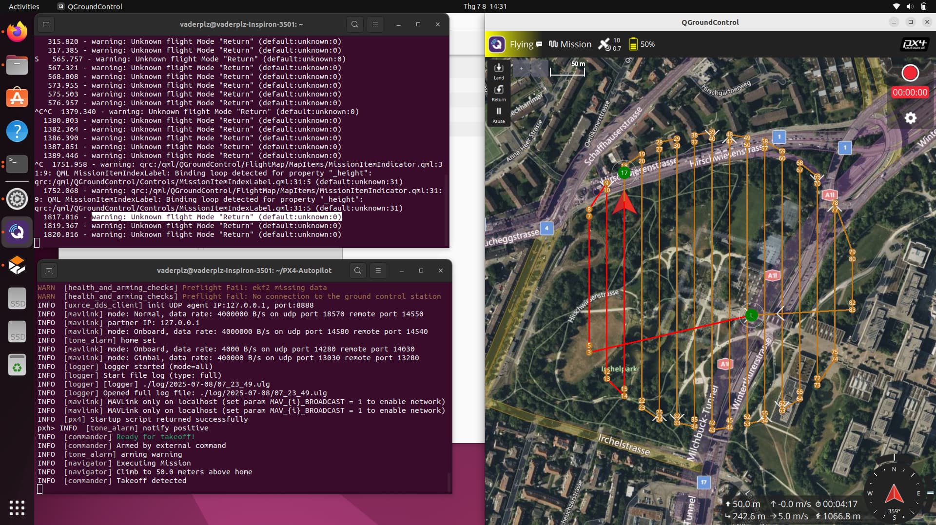

Warning: Unknown flight Mode "Return" (default:unknown:0)
Hi everyone. I am new to PX4 simulation, currently using Ubuntu 22.04 and QGround Control
On my first simulation I got an error like this which I cannot find anywhere online. So if anyone know how to solve it please let me know thanks.
It’s seems like a QGC error because there are no log on this error in px4 terminal, only on QGC terrminal.
P/S: I have reinstall several times, also try to run on virtual machine, same result.
Try QGC v5 (in release candidate at the moment), or v4.4.5
Thankyou, the older version worked nicely!
