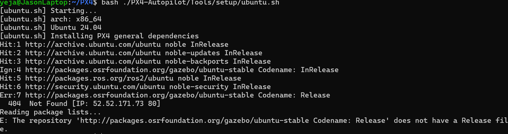

Im currently following this page to setup PX4:
However, I seem to run into an error when I run this command:
bash ./PX4-Autopilot/Tools/setup/ubuntu.sh
Does anyone know a fix to this? Thanks
Hi.
It seems that Gazebo installation is causing some issues.
Why not add the --no-sim-tools option when running the setup script?
bash ./PX4-Autopilot/Tools/setup/ubuntu.sh --no-sim-tools
You can install Gazebo separately if needed.
