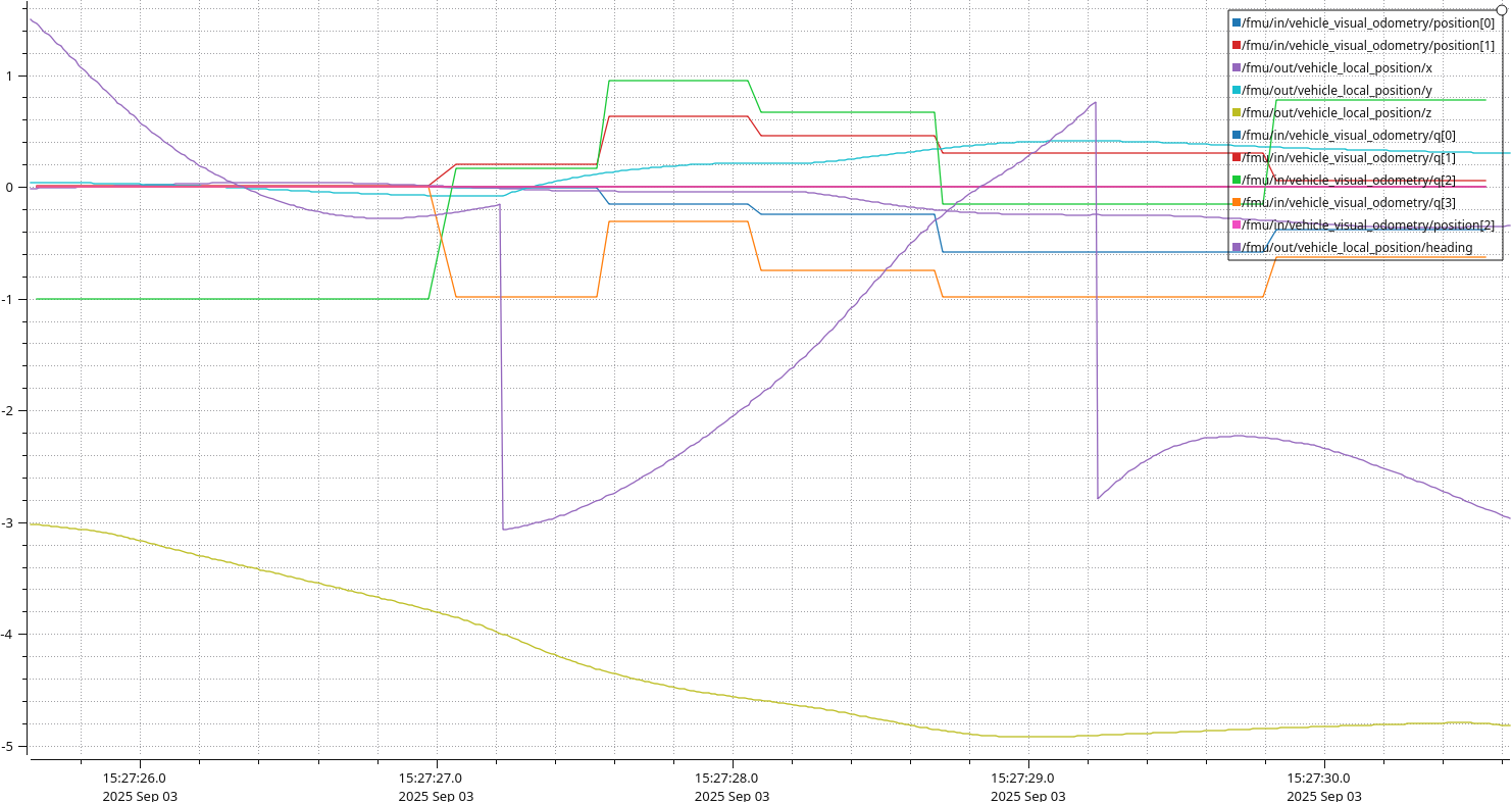

I am able to pass the required estimates of position and quaternion data , but qudacopter is rotating continuously even after adjusting code to transform from ENU to NED.
Adding graph generated by plotjuggler .
Can anyone help me in proper transformation logic and any mistake which I am doing
