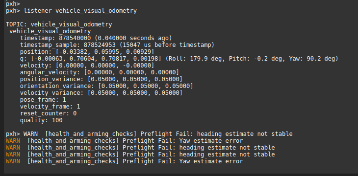

Hello, I’m a beginner developer working with PX4.
I’m currently developing a simulation using PX4 SITL version 1.15 with Gazebo Harmonic. I’ve modified the drone model to use a Livox LiDAR and am using a custom model named gz_x500_mid360.
Both point cloud and IMU data are being published correctly.
I’m forwarding the Gazebo topics to ROS 2 and using fast_lio for processing. As a result, /Odometry is being published, and the mapping appears to work well in RViz.
The issue arises when PX4 tries to consume the /Odometry data produced by fast_lio.

    RCLCPP_INFO(this->get_logger(), "ROS ENU Pos: x=%.4f, y=%.4f, z=%.4f",
                msg->pose.pose.position.x, msg->pose.pose.position.y, msg->pose.pose.position.z);
    RCLCPP_INFO(this->get_logger(), "PX4 NED Pos: x=%.4f, y=%.4f, z=%.4f",
                px4_odom_msg.position[0], px4_odom_msg.position[1], px4_odom_msg.position[2]);
    RCLCPP_INFO(this->get_logger(), "ROS ENU Q: x=%.4f, y=%.4f, z=%.4f, w=%.4f",
                msg->pose.pose.orientation.x, msg->pose.pose.orientation.y,
                msg->pose.pose.orientation.z, msg->pose.pose.orientation.w);
    RCLCPP_INFO(this->get_logger(), "PX4 NED Q: x=%.4f, y=%.4f, z=%.4f, w=%.4f",
                px4_odom_msg.q[1], px4_odom_msg.q[2], px4_odom_msg.q[3], px4_odom_msg.q[0]);
int main(int argc, char *argv)
rclcpp::init(argc, argv);
rclcpp::spin(std::make_shared());
rclcpp::shutdown();
return 0;
When I command the drone to take off to 5 meters, it fails to localize properly and begins drifting uncontrollably until it crashes into obstacles and falls.
I’m unsure if this is due to a problem in the coordinate frame conversion or incorrect EKF parameter settings.
The parameters I’ve set are as follows:
bash
param set EKF2_EV_CTRL 3
param set EKF2_EVP_NOISE 0.2
param set EKF2_EVV_NOISE 0.2
param set EKF2_EVA_NOISE 0.2
param set EKF2_AID_MASK 24   # This one does not seem to exist in the current PX4 version, which may be part of the problem
param set EKF2_HGT_MODE 3
I would greatly appreciate any help in diagnosing or resolving this issue.
Thank you.
