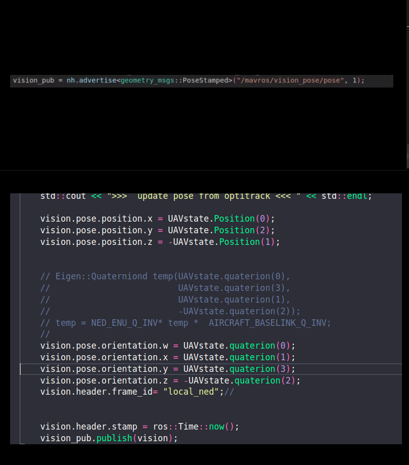

Interestingly, when I use firmware version 1.13.3, the drone can fly normally with no changes to the onboard computer code except for one place. In the messages sent to the flight controller, I did not even set vision.header.frame_id = “??”; I am unsure what to write here, but the flight controller operates correctly in position mode.

Here is the ros node in orin nx i send the data to pixhawk:

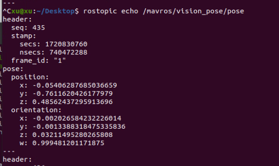

The topic of orin nx running output is as shown in the figure

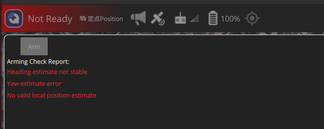

But QGC always prompts error:
yaw estimate error no valid
local position estimate
heading estimate not stable
2024-07-14 00-28-10屏幕截图

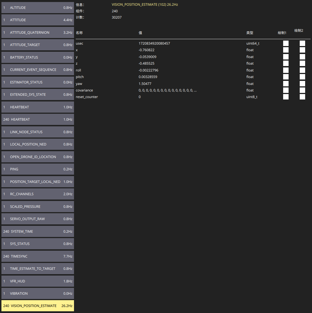

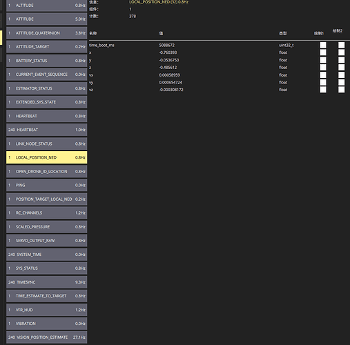

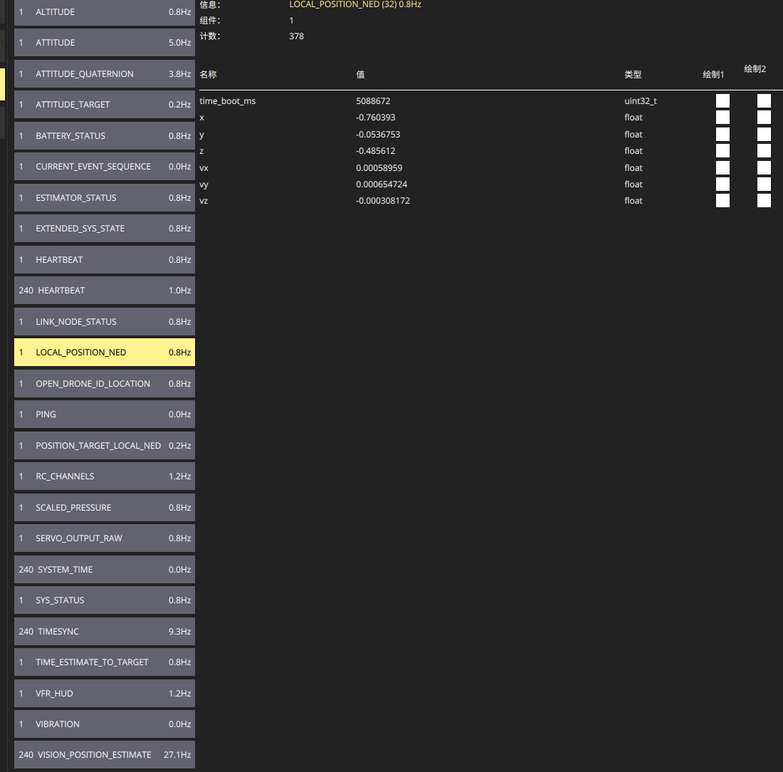

Additionally, I can see the VISION_POSITION_ESTIMATE message and LOCAL_POSITION_NEDin the real-time MAVLink messages detected by MAVLink.
