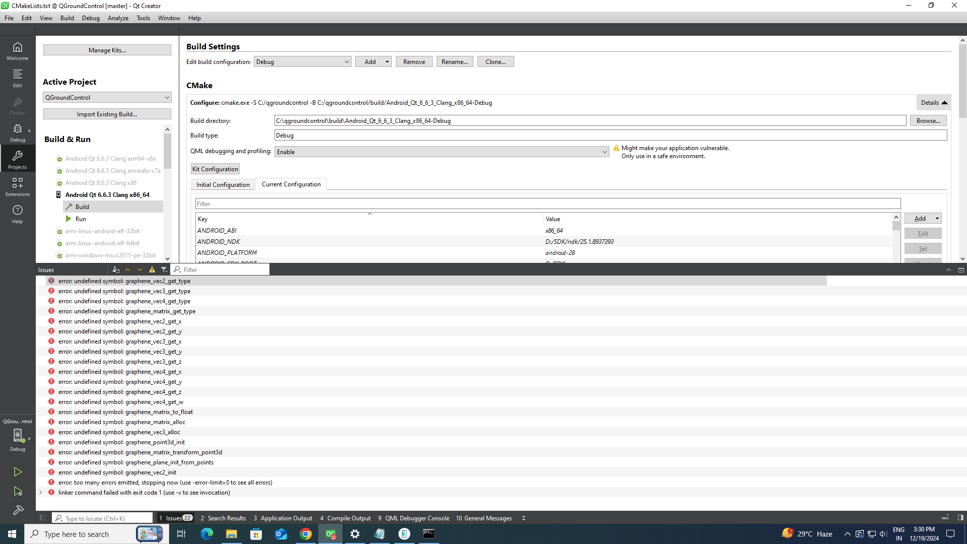

FAILED: libQGroundControl_x86_64.so
C:\Windows\system32\cmd.exe /C “cd . && D:\SDK\ndk\26.1.10909125\toolchains\llvm\prebuilt\windows-x86_64\bin\clang++.exe --target=x86_64-none-linux-android23 --sysroot=D:/SDK/ndk/26.1.10909125/toolchains/llvm/prebuilt/windows-x86_64/sysroot -fPIC -DQT_QML_DEBUG -DANDROID -fdata-sections -ffunction-sections -funwind-tables -fstack-protector-strong -no-canonical-prefixes -D_FORTIFY_SOURCE=2 -Wformat -Werror=format-security -fexceptions -frtti -stdlib=libc++ -g -fno-limit-debug-info -Wl,–build-id=sha1 -Wl,–no-rosegment -Wl,–no-undefined-version -Wl,–fatal-warnings -Wl,–gc-sections -Qunused-arguments -Wl,–no-undefined -Wl,-Bsymbolic -shared -o libQGroundControl_x86_64.so @CMakeFiles\QGroundControl.rsp && cd .”
ld.lld: error: undefined symbol: jpeg_CreateDecompress
referenced by gstgloverlay.c:682 (/home/nirbheek/projects/repos/cerbero.git/1.22/build/sources/android_universal/x86_64/gst-plugins-base-1.0-1.22.12/_builddir/…/ext/gl/gstgloverlay.c:682)
gstgloverlay.c.o:(gst_gl_overlay_filter_texture) in archive _deps/gstreamer/install/gstreamer/x86_64/lib/gstreamer-1.0/libgstopengl.a
ld.lld: error: undefined symbol: jpeg_std_error
referenced by gstgloverlay.c:683 (/home/nirbheek/projects/repos/cerbero.git/1.22/build/sources/android_universal/x86_64/gst-plugins-base-1.0-1.22.12/_builddir/…/ext/gl/gstgloverlay.c:683)
ld.lld: error: undefined symbol: jpeg_stdio_src
referenced by gstgloverlay.c:684 (/home/nirbheek/projects/repos/cerbero.git/1.22/build/sources/android_universal/x86_64/gst-plugins-base-1.0-1.22.12/_builddir/…/ext/gl/gstgloverlay.c:684)

ld.lld: error: undefined symbol: png_sig_cmp
referenced by gstgloverlay.c:764 (/home/nirbheek/projects/repos/cerbero.git/1.22/build/sources/android_universal/x86_64/gst-plugins-base-1.0-1.22.12/_builddir/…/ext/gl/gstgloverlay.c:764)

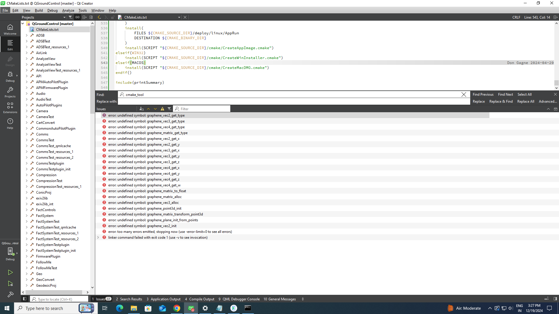

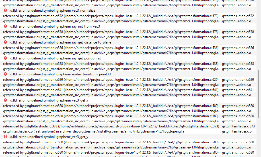

ld.lld: error: undefined symbol: graphene_matrix_get_type
referenced by gstgltransformation.c:242 (/home/nirbheek/projects/repos/cerbero.git/1.22/build/sources/android_universal/x86_64/gst-plugins-base-1.0-1.22.12/_builddir/…/ext/gl/gstgltransformation.c:242)
gstgltransformation.c.o:(gst_gl_transformation_class_intern_init) in archive _deps/gstreamer/install/gstreamer/x86_64/lib/gstreamer-1.0/libgstopengl.a
referenced by gstglfiltershader.c:384 (/home/nirbheek/projects/repos/cerbero.git/1.22/build/sources/android_universal/x86_64/gst-plugins-base-1.0-1.22.12/_builddir/…/ext/gl/gstglfiltershader.c:384)
gstglfiltershader.c.o:(_set_uniform) in archive _deps/gstreamer/install/gstreamer/x86_64/lib/gstreamer-1.0/libgstopengl.a
ld.lld: error: undefined symbol: graphene_matrix_alloc
referenced by gstgltransformation.c:271 (/home/nirbheek/projects/repos/cerbero.git/1.22/build/sources/android_universal/x86_64/gst-plugins-base-1.0-1.22.12/_builddir/…/ext/gl/gstgltransformation.c:271)
gstgltransformation.c.o:(gst_gl_transformation_init) in archive _deps/gstreamer/install/gstreamer/x86_64/lib/gstreamer-1.0/libgstopengl.a
referenced by gstgltransformation.c:272 (/home/nirbheek/projects/repos/cerbero.git/1.22/build/sources/android_universal/x86_64/gst-plugins-base-1.0-1.22.12/_builddir/…/ext/gl/gstgltransformation.c:272)
referenced by gstgltransformation.c:273 (/home/nirbheek/projects/repos/cerbero.git/1.22/build/sources/android_universal/x86_64/gst-plugins-base-1.0-1.22.12/_builddir/…/ext/gl/gstgltransformation.c:273)
referenced 4 more times

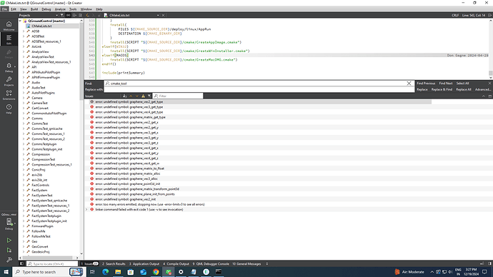

ld.lld: error: too many errors emitted, stopping now (use --error-limit=0 to see all errors)
clang++: error: linker command failed with exit code 1 (use -v to see invocation)
ninja: build stopped: subcommand failed.
09:43:23: The process “C:\Program Files\CMake\bin\cmake.exe” exited with code 1.
09:43:23: Error while building/deploying project QGroundControl (kit: Android Qt 6.8.1 Clang x86_64)
09:43:23: When executing step “Build”
09:43:23: Elapsed time: 18:47.

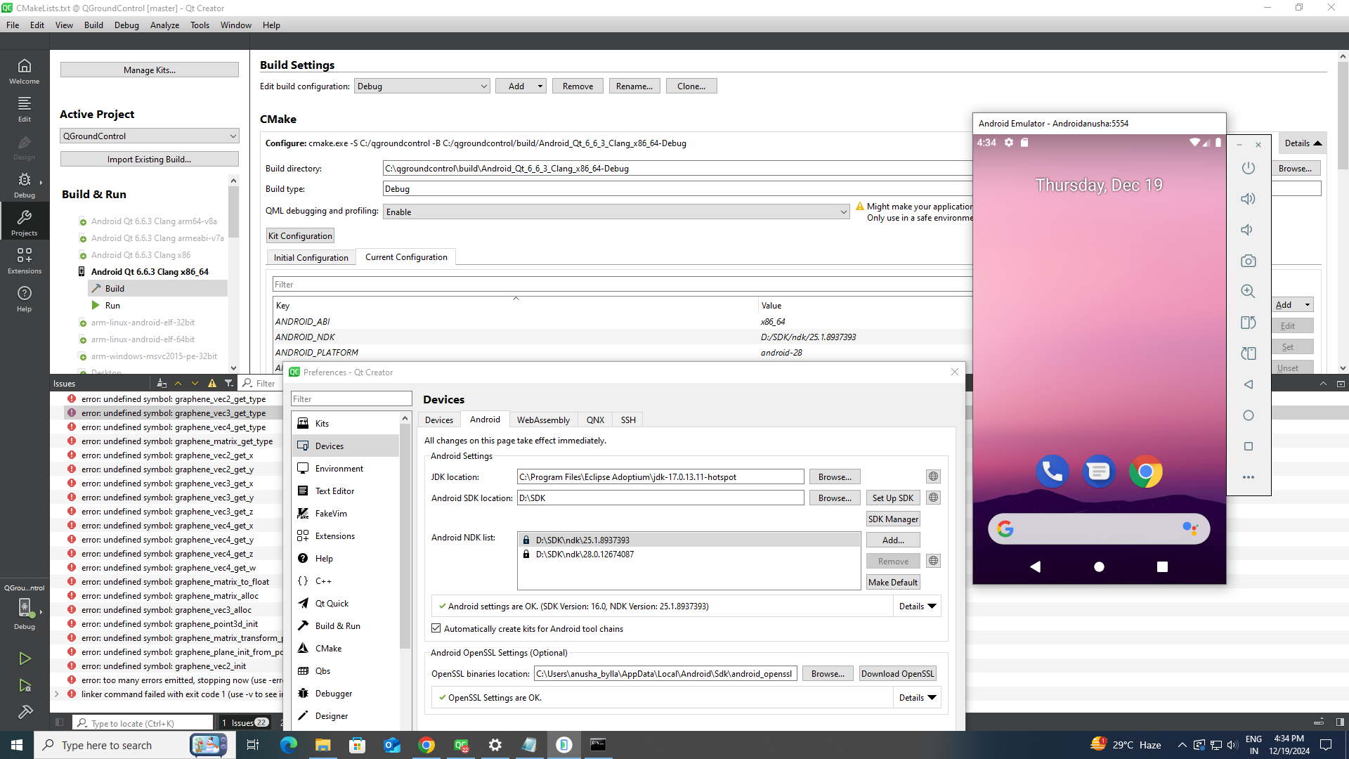

Yes, we can easily run QGC in desktop mode because we cloned it from GitHub. However, it’s not as straightforward on Android. We need to add additional dependencies, but we’re not sure what they are or how to implement them.

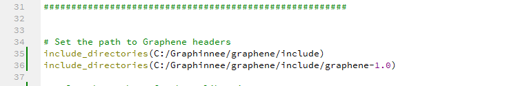

In my case, I’ve downloaded GStreamer for Windows to run on desktop, but now I need to download and set it up for Android as well, since it’s not supported for the QGC Android version.
In my opinion, it would be worth trying to download and configure GStreamer for Android to see if that resolves the issue.
When configuring CMake for Android, it downloads GStreamer automatically. I even downloaded GStreamer for Android manually and provided its path in CMake, but it still doesn’t work.
Have you added these paths to the environment variable?
no , just passed the directory
like this
Please run the following command in the Command Prompt and send me a screenshot of the output. I’ll explain what I’ve already tried, as I’m still encountering the same errors. Let’s see if you’re able to successfully install it.
echo %PATH%
