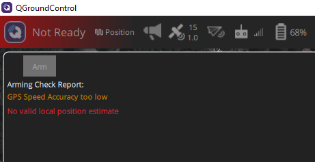

I’m having trouble clearing the arming checks because of GPS related warning.

What are the warnings? Can you share screenshots/text? It sounds related to [Bug] GPS failure, notify user · Issue #24355 · PX4/PX4-Autopilot · GitHub
Yes, the symptoms described in the bug report sound a lot like what I’m experiencing - except I’m getting them during the pre-arm checks.
Here’s a couple of screen shot examples:
But in addition to these, I’ve also gotten these warnings - sometimes multiple at the same time:
“Height Estimate Not Stable”
“Position Error Estimate”
I’ve gotten these messages with as many as 22 satellites locked.
I didn’t see a solution or work-around in the bug report. Do you have a suggestion?

It sounds like interference. Can you turn on logging from boot (SDLOG_MODE), upload to px4 flight review, and share the link?

Yes, I agree, it does sound like interference.
But since I’m new to PX4 (after working 5 years with ArduPilot) it wanted to cover all the possibilities.

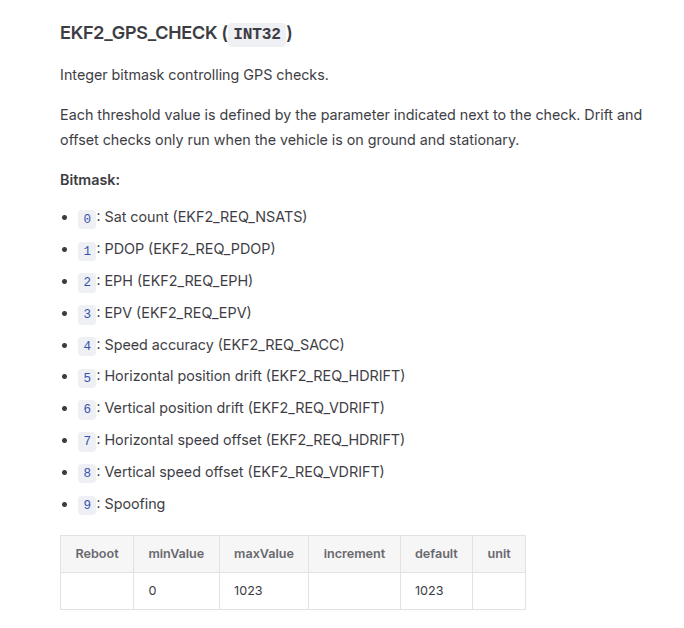

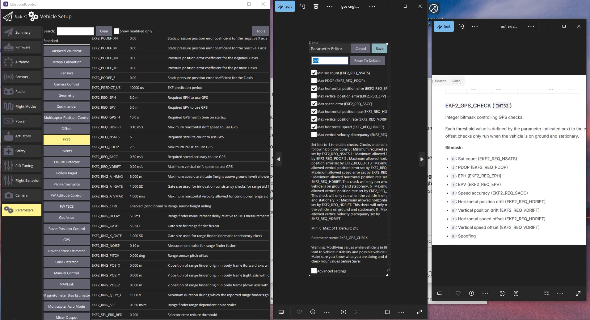

Regarding the param reference - as I displayed in the screenshot on my post above, the param reference is wrong for EKF2_GPS_CHECK. It mentions things like “spoofing” (bit 9) that isn’t represented for that parameter in Qgroundcontrol.
And two bit options reference the same thing.
I was hoping someone might take a peek at the codebase and explain what the options really mean - so that whomever maintains the WIKI could correct it.

The parameters at the link above are autogenerated and updated daily, so they will always be in sync. QGC fetches the parameter metadata, but I think at some point this might have broke in QGC v4. Either that or you might need to clear the QGC cache. Right now the maintainers are working on a QGC v5 release, I would recommend using the daily build and if any issues persist posting in the QGC discord channel or on the GitHub. Don has been fixing a ton of issues and is very responsive.

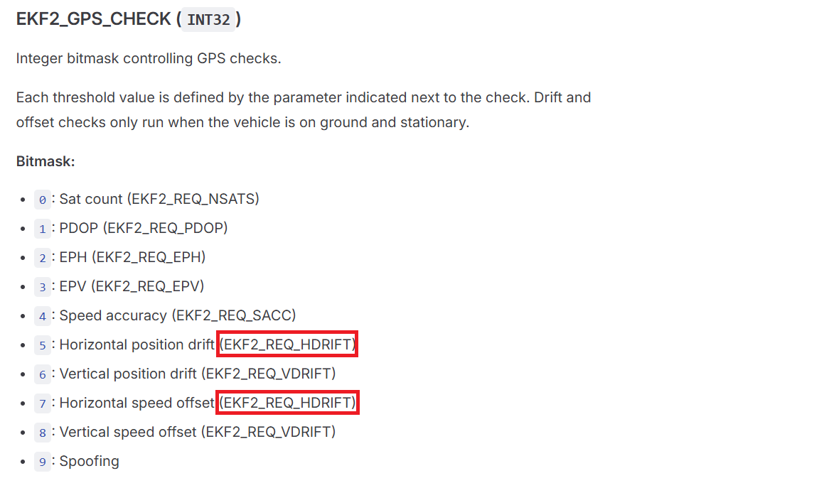

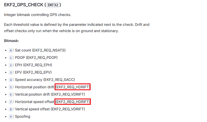

Please note that the WIKI for EKF2_GPS_CHECK references EKF2_REQ_HDRIFT for both bit 5 and bit 7 in the bitmask.
If the WIKI is auto generated from the codebase, does that mean there is an error in the codebase?

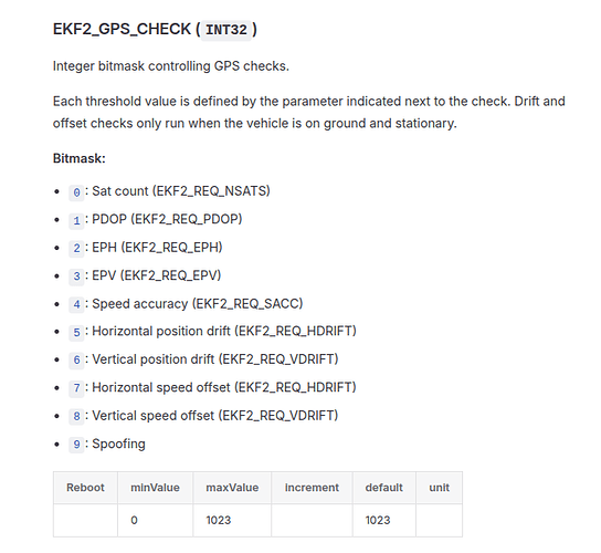

I tried using my Android Qgroundcontrol app, and this is the display for EKF2_GPS_CHECK:
This has the same error in the description of bit 5 and bit 7, where the reference to EKF2_REQ_HDRIFT is listed twice. But it does show “Spoofing” for bit 9 in the bitmask.

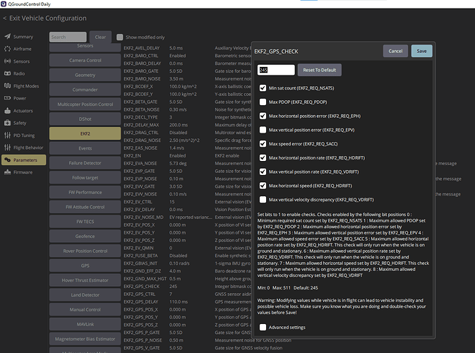

I tried the Windows daily build and this is what it displays:
This has the same error in the description of the bitmask as the stable Windows version of Qgroundcontrol. Note that bit 9 still does not mention spoofing, and the duplicate references on bit 5 and 7.

It does look like EK2_REQ_HDRIFT is used for both of those checks.
If you want to look through the code, the GPS checks happen here:
And the pre-arm checks are here:
Thank you for investing the time in this.
If bit 5 and bit 7 both respond to the value of EKF2_REQ_HDRIFT then perhaps there’s a mistake in the program logic. You can’t raise one and lower the other. Or maybe there’s something else going on in the code. It’s been a long time since I was a programmer - but I’m pretty sure this represents a problem.
