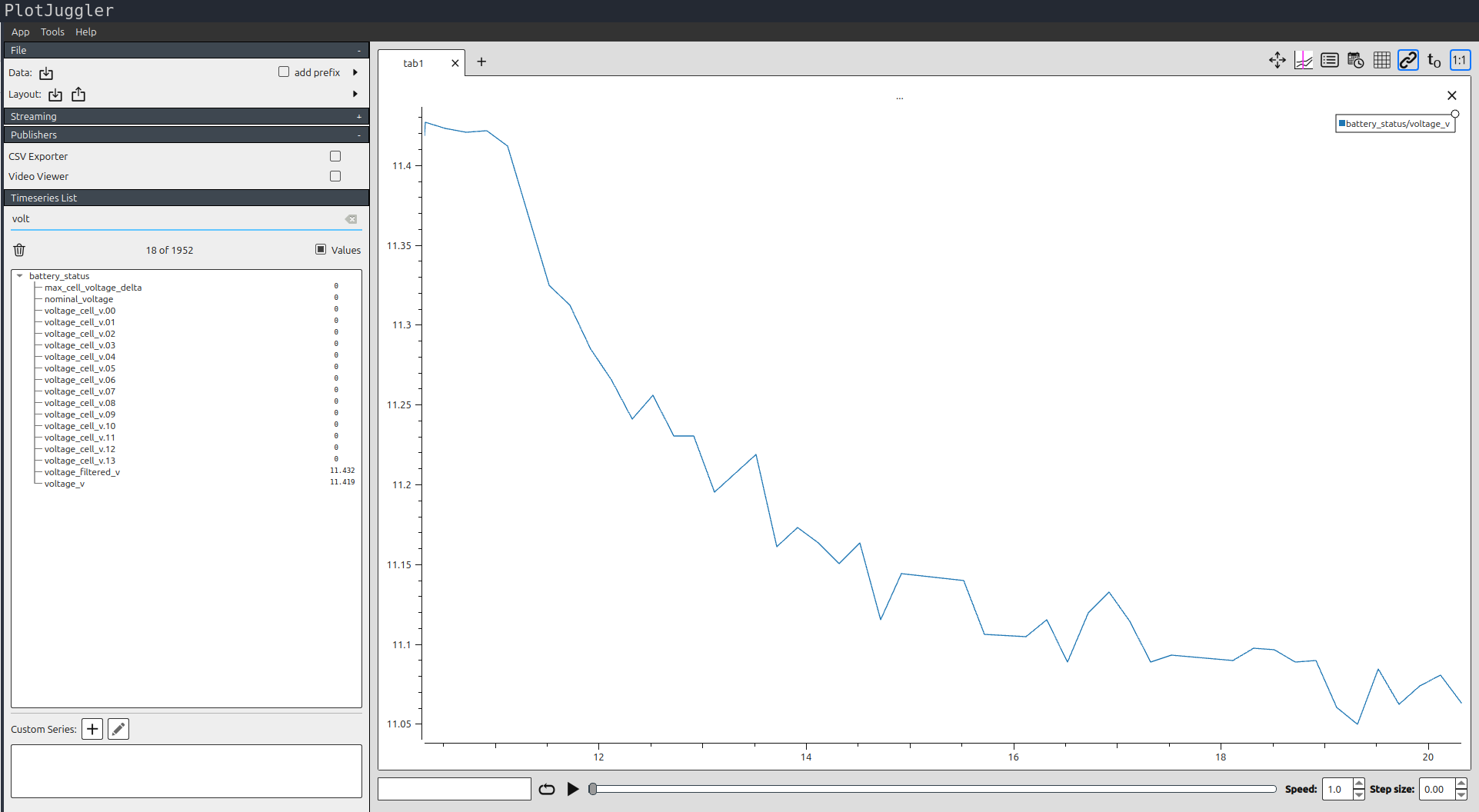

Why there is no voltage log?
Anyone can help?
EDIT: SDLOG_PROFILE=2047
Do you have a power module connected and correctly configured? Do you see the voltage in QGC?
Yes, I saw voltage in QGC. I have MicroAir H743 AIO V2, which has Voltage&Current Monitoring feature.

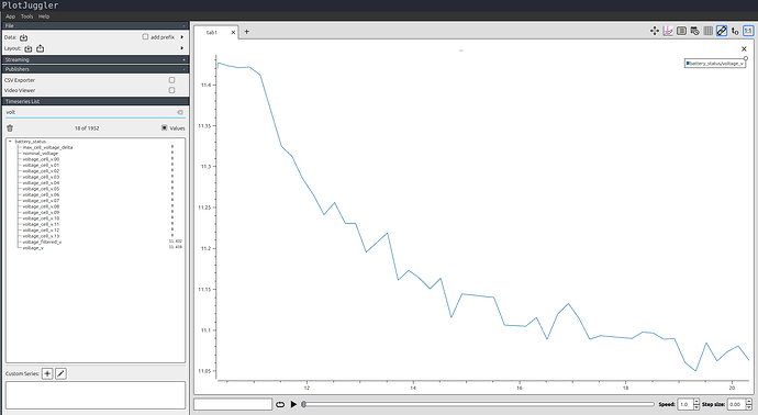

Looks like the voltage is in the log and flight review doesn’t display it:
Not sure why. I’m pinging @bkueng to check.
Thanks for confirming and sharing that PlotJuggler can display the voltage data from the ulog file. Could you please clarify what the unit of the x-axis represents? Is it in seconds?
The problem was that it’s a log from an older PX4 version that does not contain the internal_resistance_estimate message field. I’m adding a check for that here: fix battery plots: check for 'internal_resistance_estimate' data field by bkueng · Pull Request #314 · PX4/flight_review · GitHub
Yes, that is correct
@JulianOes @bkueng Thank you very much.
