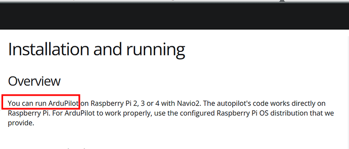

Obviously got confused with the details:
and
Their forum:
Note on the side: Navio2 has a problem whereby GPS and certain sensors are being ignored at random. This causes mid flight crashes at random and there is no fix.
You can see many reports about this on their forum and you may have also noticed they no longer provide any software updates.
